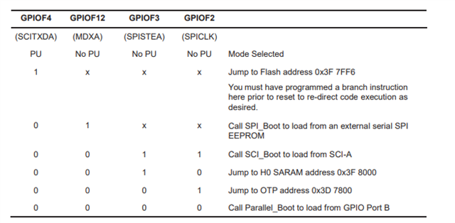

    Can you confirm which boot mode you are using to download the flash kernel/data:
    Uniflash will use JTAG pins to download the kernel/API and data, where your production with FPGA will use one of the other modes, SPI, SCI, or parallel boot.
    Thinking about FPGA(external changes) here's where I would start looking:
    1)Boot pins, we need to make sure the below pins are driven properly for some duration after power up, so the BROM will correctly identify the Boot Mode.  Can we make sure the pins are held at the same state after XRSn de-asserts for both old a new FPGAs?

  • 1)Boot pins:
    Set for Jump to Flash address 0x3F7FF6. SCITXDA is drive high by the FPGA. Monitored all the pins and didn't see them change state during the programming.
