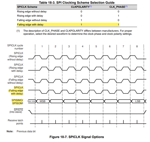

We are using TMS302F28379D to read ADXRS290 gyroscope data. According to datasheet, SPI mode is POL1 and PHA 1 but we are only able to read and write correct data from ADXRS290, if we set POL1 and PHA0.
We also checked with an IMU, which has similar SPI mode requirement and have observed similar behaviour that the correct data is received only when SPI configuration is set to POL1 and PHA0. Below is the configuratiuon which worked for us.

1. What could be reason for the same?

We also tried the multi-byte read operation and the data was found to be correct when the read and write operation was performed in the main function but outside the "for" loop but when the multi byte read operation is being performed inside the for loop, the incoming data is errorneous.
We configured CS as GPIO when using in this mode.

3. We are also runnign a 100us timer 0. if this read operation is performed inside the loop, no matter if it is a single byte read operation or multi bye the data received is erroneous.
Request you to help us out in identifying the issue.
