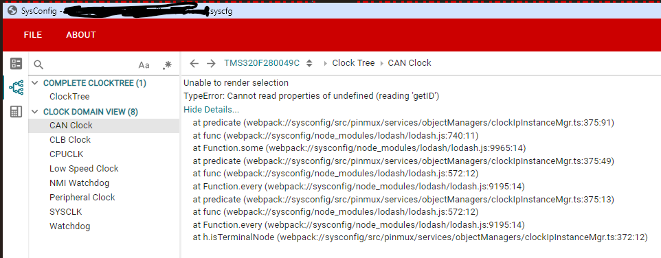

SYSCONFIG: SysConfig fail
Part Number: SYSCONFIG
I just installed a fresh copy of Win11 and CCS 20.4.1., and standalone SysConfig 1.26.2+4477.
We use F280049C.
When doing some settings in ClockTree, then click CLOCK DOMAIN VIEW, then click CAN CLOCK it gives error:
Unable to render selection
TypeError: Cannot read properties of undefined (reading 'getID')
Hide Details...
at predicate (webpack://sysconfig/src/pinmux/services/objectManagers/clockIpInstanceMgr.ts:375:91) at func (webpack://sysconfig/node_modules/lodash/lodash.js:740:11) at Function.some (webpack://sysconfig/node_modules/lodash/lodash.js:9965:14) at predicate (webpack://sysconfig/src/pinmux/services/objectManagers/clockIpInstanceMgr.ts:375:49) at func (webpack://sysconfig/node_modules/lodash/lodash.js:572:12) at Function.every (webpack://sysconfig/node_modules/lodash/lodash.js:9195:14) at predicate (webpack://sysconfig/src/pinmux/services/objectManagers/clockIpInstanceMgr.ts:375:13) at func (webpack://sysconfig/node_modules/lodash/lodash.js:572:12) at Function.every (webpack://sysconfig/node_modules/lodash/lodash.js:9195:14) at h.isTerminalNode (webpack://sysconfig/src/pinmux/services/objectManagers/clockIpInstanceMgr.ts:372:12)
Any ideas how to solve this?
Rudy

  • Hi Ira,
    Opening SysConfig in CCS works, but not in the standalone tool.

  • I deleted as you requested and it looked promising. It looks like I can do some settings (+Add blocks) and save them. I noticed that no board.h and board.c is generated this time (it does generate pinmux .h .c  files). I can also save this config, but I cannot open it anymore due to an error.
  • Do you have an instance named DC-DC1 in your sysconfig file? Can you rename it to something like DCDC1 or DC_DC1? The hyphen can create an issue in instance name at times and JS may treat it like a subtraction.
    Ira
  • Hi Ira,
    Note that it fixes the issue when the following lines are changed (see first line: the hyphen must stay!), from:
    const DC-DC1 = scripting.addPeripheral("DC-DC");
    DC-DC1.$name = "MyDC-DC1";
    DC-DC1.$suggestSolution = "DC-DC1";
    DC-DC1.VFBSW.$suggestSolution = "GPIO22_VFBSW";
    DC-DC1.VSW.$suggestSolution = "GPIO23_VSW";
    To:
    const DC_DC1 = scripting.addPeripheral("DC-DC");
    DC_DC1.$name = "MyDC_DC1";
    DC_DC1.$suggestSolution = "DC_DC1";
    DC_DC1.VFBSW.$suggestSolution = "GPIO22_VFBSW";
    DC_DC1.VSW.$suggestSolution = "GPIO23_VSW";
    Can you pass it to development, this is a time conuming issue?
