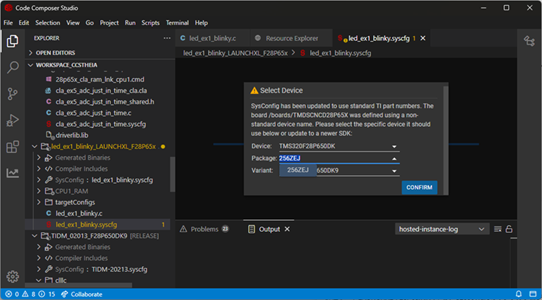

I have obtained the LAUNCHXL-F28P65x evaluation board and would like to run it, but I am having trouble selecting the target device in the C2000Ware sample project.
Could you please provide guidance on how to build a project that works with the LAUNCHXL-F28P65x?
I have followed the following steps:
  1. Imported a sample project from the CCS Resource Explorer:
    • C2000Ware > English > Devices > F28P65X > F28P650DK9 > Examples > Driverlib > c28x > led > led_ex1_blinky
  2. When I build the project, I receive the following warning in the console:
    • Warning: SysConfig has been updated to use standard TI part numbers. The device TMS320F28P659DK-Q1 has been automatically selected. If this is not the desired please open SysConfig to change it.
  3. When I try to change the device by opening the .syscfg file, I am presented with a device selection screen.screenshot.png
  4. However, when I select F28P650DK9, I am only given the option to choose a package type of 256ZEJ, and I am unable to select the 169NMR package that is actually used on the evaluation board.
My software versions are as follows, and I believe they are all up-to-date: * CCS: 20.4.1.4__1.10.1 * C2000Ware: 6.00.01.00

  • Hi Yuki,
    Thank you for your patience. I was able to see the 169NMR package by following these steps.
    1. Import the project into your CCS Workspace.
    2. Now if you open the .syscfg file you will get a pop up and you will be asked to choose the variant. Currently you will only be able to see one package - 256ZEJ, like this
    3. Now in order to see the 169NMR package, you need to change the SysConfig flags.
    4. Right Click on project in explorer -> Properties -> Tools - > SysConfig. You will see the flags mentioned.
    5. Now modify the flags to use 169NMR package. Make sure your flags are the same as below image
    6. Now click on the "tick" symbol on top right to save these flags.
    7. Click on "Save and Close"
    8. Rebuild the project.
    9. Try to reopen the .syscfg and you should be able to see the 169NMR package now.
    Once you create your syscfg with the 169NMR package the warnings should go away.
    Ira

  • Hi Yuki,
    This is what I heard back from them.
    SysConfig used to provide zero restrictions on what business units could use as a device name.  Three years ago, SysConfig was updated to only accept GPNs.  As such, when SysConfig starts, and one of the old legacy names is supplied as the device to use (either in the project properties, or in the comments of the .syscfg script), it looks up what the equivalent GPN is and updates accordingly.
    Unfortunately, there are cases where two GPNs do not differ in anything that matters to SysConfig.  As such, we have many cases where the legacy freeform name of a device maps to more than one GPN.  The dialog the user is seeing is what SysConfig presents to users in this case.
    Effectively, this user is not being asked to indicate what device they would like to use – they are being told that they imported an example which works only with a specific legacy device name/package/variant, but it now maps to multiple possible GPNs, and he must pick the one that maps to his precise device.  Hence, he is not given the option to pick a 169 pin package because the example wasn’t setup for one.
    Having said this, there is a migration feature inside of SysConfig.  The customer can get this feature via the “switch” button in the device view.  That will provide complete freedom to select any GPN/package/variant that the SDK supports.  It will likely leave the user with a lot of errors to correct if the device is significantly different, but if they don’t lock down the pinmux choices, I suspect migrating to a 169 pin package will likely “just work” for what they’re trying to do.
    Long term, ASM can completely eliminate this dialog, and the confusion it causes, by fixing the SDK examples to specify GPNs instead of the legacy device names.  The BU was notified of this at the time the change was rolled out.
    Looks like its an issue from the SDK side with respect to how the examples are provided.
