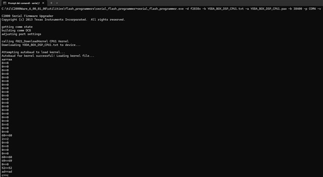

I would like to flash CPU1, CPU2 and CM on the TMS320F28388D and I am following Application Note "Serial Flash Programming of C2000™ Microcontrollers".
The serial_flash_programmer.exe application requires the <kernel file> on command line:
"serial_flash_programmer.exe –d <device> -k <kernel file> -a <app file> -p COM <num> [-b] <baudrate>"
Where do I find the <kernel file> for CPU1, CPU2, and CM?
This file must be in the ASCII SCI boot format.
