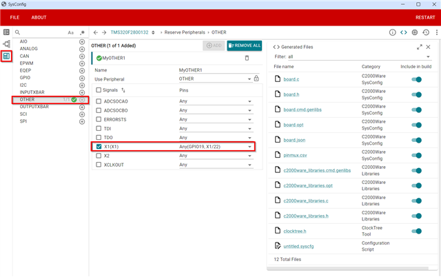

Part Number: TMS320F2800137
I'm looking for a config possibility of the ExtR mode in sysconfig.
Can you do it here:
Regards, Holger
Can you do it here:
Regards, Holger
Are you requesting ExtR support in SysConfig? It can be implemented using driverlib functions, as described by this thread: SYSCONFIG: setting F280013x ExtR mode
Matt
Hi Matt,
what about the sysconfig picture above? Can you reserve that pin with it?
Regards Holger
Hi Holger,
Yes, that would reserve the pin. You can also use the "Reserve Peripherals" tab to accomplish the same (without auto-generating code in board.c/board.h).
Matt
