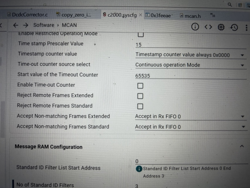

We setup three filter elements as below, which should covers any ID and all frames go to FIFO0,
image.png however, the frames are not received by the C2000. The interrupt is never entered and we are seeing error frames from the debugger, which may result from that C2000 is not sending ACK.
Next, we turned on the acceptance of non-matching frames to FIFO0 like below:
Then the frames can be receieved properly, both standard ID and extened ID are tested, with correct ID and data. This result should rule out issues in the interrupt configration. The problem would be why the filter elements failed to match the in coming frames

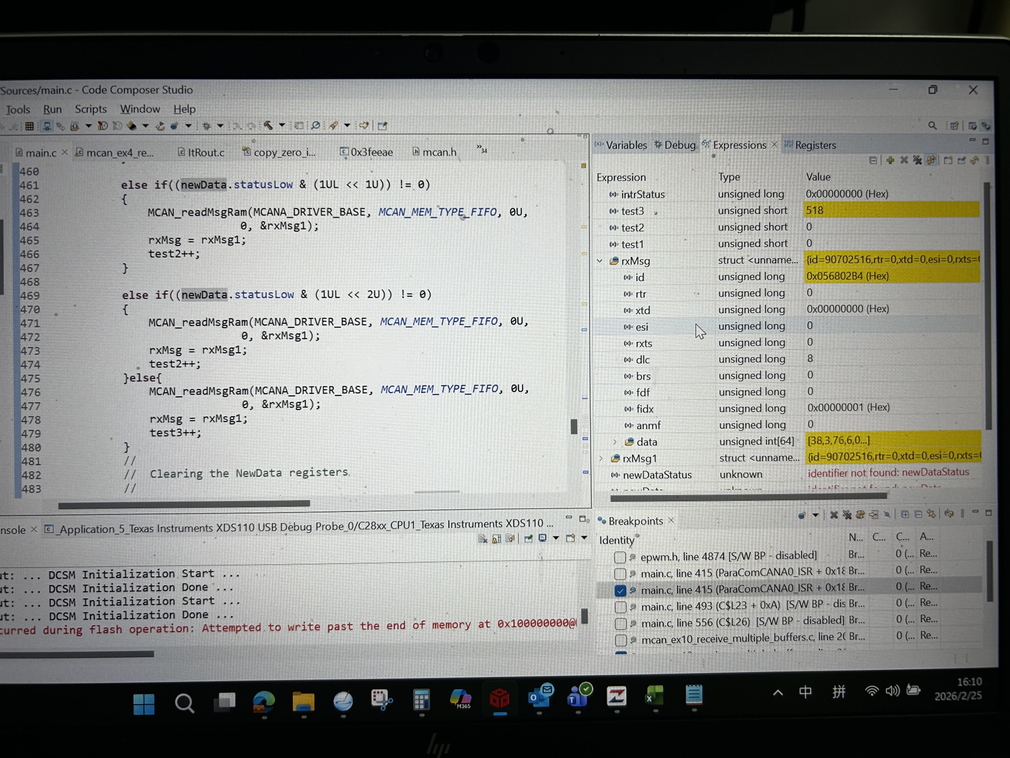

I illustrted the issues in below screen shot.
The left is the code in the ISR, where I use if statement to judge with filter element has matched the incomming frames. If any element matches, variable test2 would add one. If non of the filter element is matching, then test3 add one.
In the expression window you can see the rxMsg struct is displaying the receieved data and id correctly, however it comes fom the "Non-matching" route as only test3 is non-zero, and test2 is zero.
Why the filters elements failed to match?

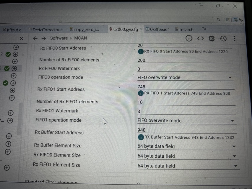

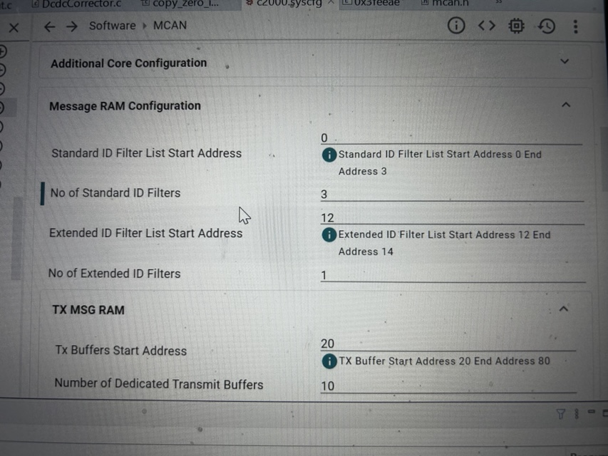

I am adding some relevant configuration here as well. All configration are done by syscfg.
