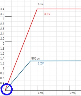

Could you explain "VDDOSC and VDD must be powered on and off at the same time." in more detail ?
Does it mean that the ramp up point circled in blue is the same between VDDOSC and VDD ?
Is there any problem in the following power sequence ?

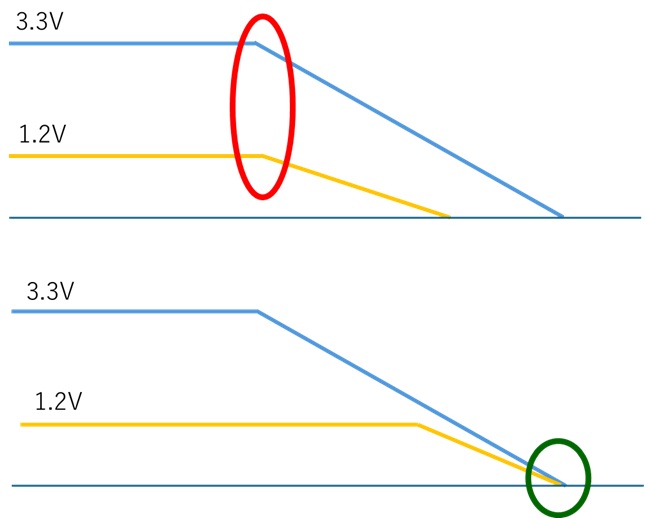

How about power off ?  VDDOSC and VDD must be powered off at the same time at the point circled in red or green below ?

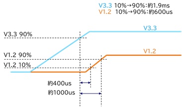

Could you check the following sequence ? Actually, this is the power sequence on the customer’s system.
If there is a problem, what is a problem ?
If the INTOSC frequency drift occurs due to errata, the big drift occurs immediately after INTOSC starts up ?
Or the drift was very small at the INTOSC starts up and it gradually increases by accumulating ?
    JC: Ideally, below would be the power up condition:
    On the power up case below, the highlighted region would still cause some minimal leakage to the component and if application power cycles the device several times then the accumulated shift on the component may cause some frequency drift.

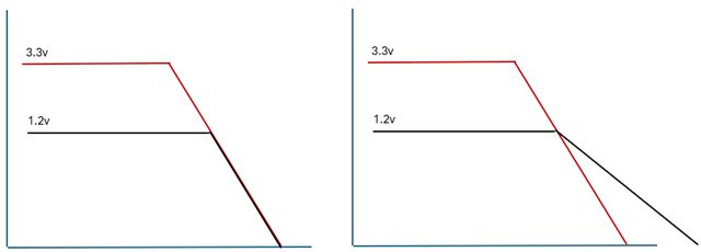

    JC: Yes, similar to the condition in power on, power off should be done about the same time.  Typically, there is a large capacitor on VDD so the discharge may take longer, but this is ok since there will not be any current path to the component.  Below diagram on the left shows the ideal power down sequence.  The right diagram shows the typical power down when there is a large capacitor on VDD to allow for discharge.  Both power down sequencing will prevent current from flowing into the component to cause a shift.
    JC: Yes, there is a problem with this.  The component will be stressed for a duration of ~400us.  If power cycling is done in the application often, then the shift accumulates over time.
    JC:  It will not be a big frequency drift at first.  The accumulated time where VDDOSC causes current flow to the component when VDD has not powered up would continuously cause component shift to cause frequency drift.
