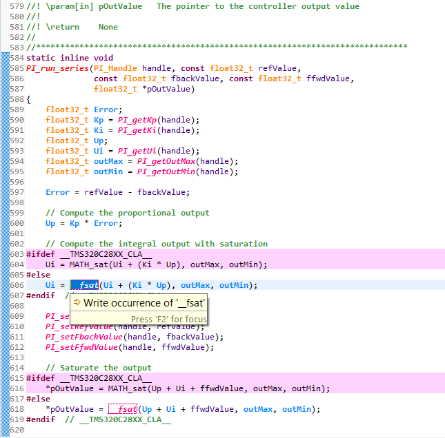

 When the motor estimated current is being set high as to reach the trajectory speed hertz, the PI integrator swings current wildly nonmonotonic linear ramp between the negative and positive integrator input values below! Oddly that also causes DC inductive voltage in the PI run series to bounce DC in Idq frame (motor1_drive.c).
Analyzing the PI set series function it seems __fsat missing but the compiler skips over it or  CCS cannot find it?
  Anyway the bMainDecel we added now stops DC bouncing in the PI min/max current controller during deceleration, also stops tripping OVC faults!  Yet still has excessive nonlinear Acceleration to trajectory current swings, seemingly caused by integrator in the PI current controller not saturating?
Why to use function __fsat ?

Error = refValue - fbackValue;
// Compute the proportional output
Up = Kp * Error;
 // Maximum voltage output
obj->VsMax_V = objUser->maxVsMag_pu * obj->adcData.VdcBus_V;
PI_setMinMax(obj->piHandle_Id, -obj->VsMax_V, obj->VsMax_V);
