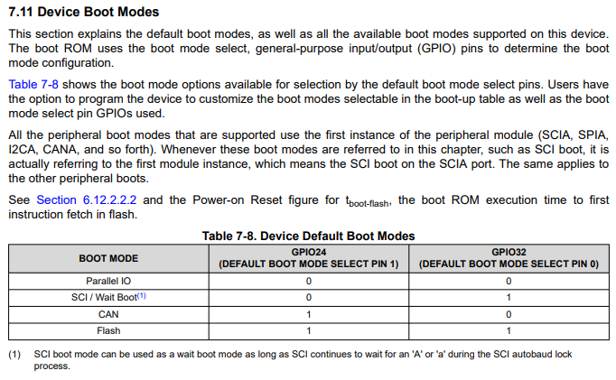

S1A P1->Off, S1A P2->Off.
S2 P1->0(GPIO24), S2 P2->1(GPIO32) as described in the datasheet*:
S3->Internal (UP)
I'm using an MCP2221A USB to UART converter (but I've tried also an FTDI with same result). The RX pin of the MCP2221A brakoutmodule is connected to pin 76 of the control card docking and the TX pin is connected to the pin 78 of the control card docking. GND of both boards are connected.

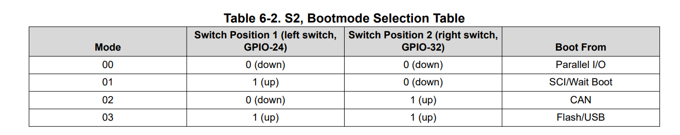

  • Hi Alberto,
    Your S1:A switch configuration is correct for bringing the UART signals to the baseboard that looks correct. For the bootmode selection switch, you should refer to the table in the controlCARD user guide. Note the positions indicated in the user guide refer to the switch level and not the logic levels which are shown in the datasheet. This is to align with the default switch position that our switch components come in from the manufacturer. Can you try with this updated configuration and let me know if the issue persists?

  • Thanks for your reply.
    Now I set:
    S2.1(GPIO24) to 1 (up) and the logic level is 3.3V
    S2.2(GPIO32) to 0 (down) and the logic level is 0+
    With this setup the UART's logic levels are not correct:
    docking pin 78 is 3.3V (PC UART TX->uC UART RX). Correct
    docking pin 76 is FLOATING (PC UART RX->uC UART TX). NOT correct it shall be 3.3V driven by the uC TX port.
    With the datasheet configuration I almost had 3.3V on both pins in idle state, as expected in a UART line.

  • Hi Peter,
    yesterday I was able to program my board. to do this I had to:
    1) reduce the uart speed to 38400 baud
    2) Modify and recompile the srial flash prog software
    3) connect PC TX and RX ti GPIO28 and 29.
    4) configure S2 pins as follows: GPIO24 =0 down, GPIO32=1up
