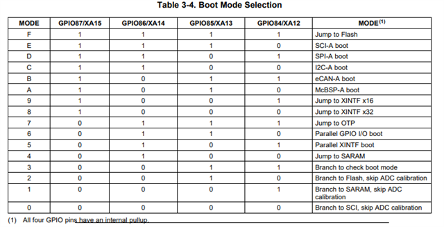

  • Harshath,
    Can you check the below boot pins, to make sure they are all pulled "high" on your board to invoke the boot to flash
    Also, a small correction to your PLL settings.
    Currently you have specified a PLLCR = 4(multiply by 4) with a DIVSEL = 1(this divides by 4) so you are going to end up with 25MHz SYSCLK.
    For 100MHz you need to use these settings:
    #define DSP28_PLLCR  8
    #define DSP28_DIVSEL     2
    This will give 25MHz * 8/2 = 100MHz.
    I think what you intended with your original settings was 25 *4/1.  DIVSEL = 3 in this case...however, we don't allow the /1 (DIVSEL = 3) if the PLL is in use, we must use either /2 or /4.
    Let me know.
    Matthew

    As long as the boot mode pins are set correctly to Boot to Flash, then the code we see during debug should match exactly what will run standalone.
    Matthew
