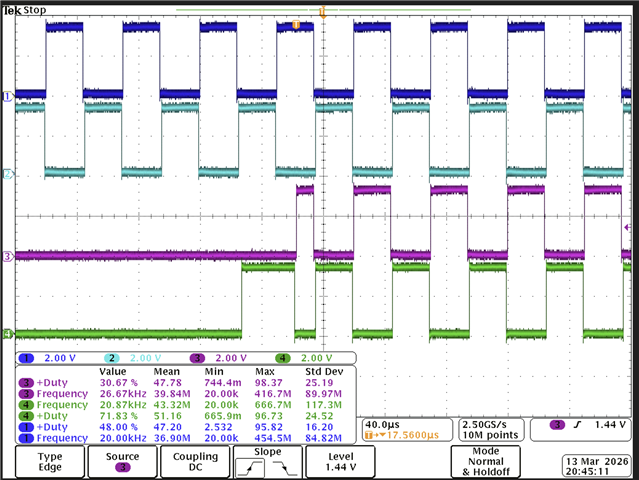

I am experiencing what I think is some contention of shadow registers being loaded when I am transitioning my PWM outputs from completely off to Active High Complementary.  I am altering both DBCTL and AQCTLA/B registers which are configured to both load on a SYNCIN event via the Global Load registers.
Here are the steps I take to turn off the PWM outputs and then turn them on again.
To turn off:
  1. Set DBCTL.OUT_MODE to 2, to bypass the deadband module on output B
  2. Set all AQCTLA and AQCTLB to 1 so that the output clears on all events
To turn them on:
  1. Set DBCTL.OUT_MODE to 3, to re-enable deadband on output B
  2. Set AQCTLA to SET the output at TBCTR = ZRO
  3. Set AQCTLA to SET the output at TBCTR = CAD
  4. SET AQCTLA to CLEAR the output at TBCTR = CAU
  5. All other AQCTLA registers are set to No Action.
The result is that my PWMs do exactly what I want except for a small 8-12ns blip on output B when transitioning from OFF, circled in red in my image.  The measurement from the blip to when its corresponding A channel gets flipped high is exactly the time of my deadband setting of 1 microsecond.
Is there some sort of order that the processor follows for what shadow registers get loaded when?  This behavior would be explained if the deadband shadow registers got loaded before the action qualifer registers because with Active High polarity, output B would want to turn on if A is low.  Is this expected behavior or is there another way I could turn on/off the PWMs to avoid this blip?

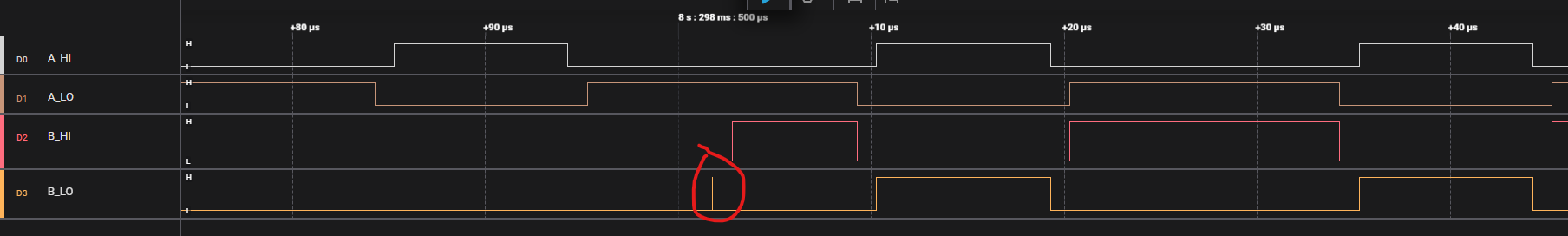

  • Hi Sumit,
    Thanks for the response and I am going to try your suggestions.  To answer your questions, yes another PWM channel is our SYNC source. For our ISR, it is the same PWM source as the SYNC and gives us ample time to update the PWM registers before the next SYNC.
    From your picture, is the green output B?  I actually don't see the blip on my end either when the initial state is B high, and A low.  I only see the blip on output B when the initial state is A high and B low.
    Looking at your Action Qualifiers, it looks like your outputs should match mine with A being high and B being low to start.
    Will
  • Yes,
    pink is output A and green is output B.
    Sumit
  • Hi Sumit,
    I tried your suggestion of re-ordering my setting of the Action Qualifiers and Deadband settings but still see the blip.  I only see the blip when the initial state of the PWMs when TBCTR = 0 is: Output A is high, and Output B is low.  Your picture has A low and B high, where I also don't see the blip.
    My Action Qualifiers when this happens are:
    ZRO: Set output
    CAU: Clear output
    CAD: Set output
    The problem looks like it happens at ZRO.  It's like output B first responds to being in AHC polarity so it gets set, then the output gets cleared because of the ZRO action.  Can you see the blip when you have a transition of OFF to A high and B low?
    Will
  • Sumit,
    I have same configuration as you have shared. To interpret the diagram above, I have drawn the event as shown below.
    You have two high or set event one is zero and other is CAD. Sync event is happening only at zero event of master blue waveform.  But the steady state rising edge is happening at CAD as shown by dark blue waveform.
    With sync happening at zero which comes after CAD event of blue, bottom pink waveform is starts late when changing software flag from off to on.
    In my configuration, CMPA is half of the TBPRD value.
    To answer your question I do not see blip on ePWMB and waveform configuration are same as you need.
    Sumit

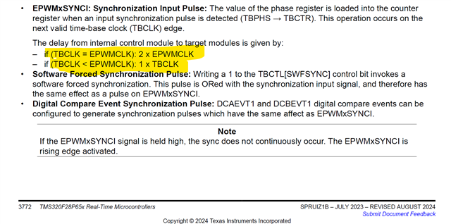

  • Will,
    In shadow load, both the DB and AQ submodules shadow loads at the same time on sync event to prevent corrupted PWM waveforms. They are usually configured to load new values at the same time to ensure a clean transition, such as at the start of a new PWM cycle. So, this may not be the issue.
    I think the issue could be racing conditon between synchronization pulse and loading these registers at TBCTR = 0.
    There is a note in TRM that says synchronization may take 1~2 TBCLK. So if you zoom in the rising edge of master and slave ePWM then you can see that difference. So generally we say add that static offset in TBPHS register and these edge will be perfectly aligned.
    Keeping this limitation in mind, one additional thing you can try with keeping all the suggested remedy above is that set global load sync event on period and not the zero. That way these registers will be ready in shadow register when TBCTR = ZERO and ready to load in active in one cycle all at once.
    This will avoid racing condition between synchronizing and global loading.
    Also, did you happen to evaluate or try the trip method I mentioned in thread above? Do you think that will work for you?
    Sumit
  • Sumit,
    I think you are correct in thinking the race condition is between the sync pulse and when TBCTR = 0, although I have global load sync event set to SYNCIN signal, not zero.  Thank you very much for looking into this.  I am considering how we want to change the PWMs by either altering the global load event or using the Trip Zone.
    Will
