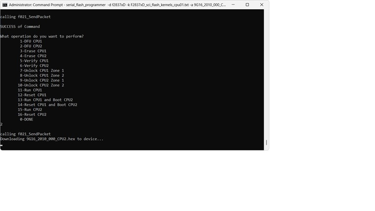

  • Hi Alex,
    Your code is excellent. I can successfully download the CPU1 firmware without any errors. I really appreciate your help.
    But I tried to download the CPU2 firmware after finishing the CPU2 kernel download. It's not starting as below.
    Let me know how to fix this problem.
    Jeong
  • Hello Jeong,
    On this device, each CPU has its own dedicated flash bank. Flash programming for CPU2's banks must be done through CPU2. You can use the flash_kernels_cpu02 project to accomplish this. To load it in, first load the CPU01 kernel, then perform the CPU1 DFU, then "Run CPU1 and Boot CPU2". This changes ownership of the SCI peripheral to CPU2 and brings it out of reset. After doing this, load the CPU02 kernel and you should be able to perform the CPU2 DFU.
    Alex
  • Hi Alex,
    Thank you for your quick response.
    I loaded the CPU1 kernel, then performed 'DFU CPU1', then ran 'Run CPU1 and Boot CPU2'. So, the CPU2 kernel was successfully downloaded. Then I tried to do 'DFU CPU2' as you proposed, but it's not starting like the above.
    And I also tried to 'DFU CPU2' after running 'Reset CPU1 and Boot CPU2', but it's still not starting as before.
    Can you let me know if you have another suggestion?
    Jeong
