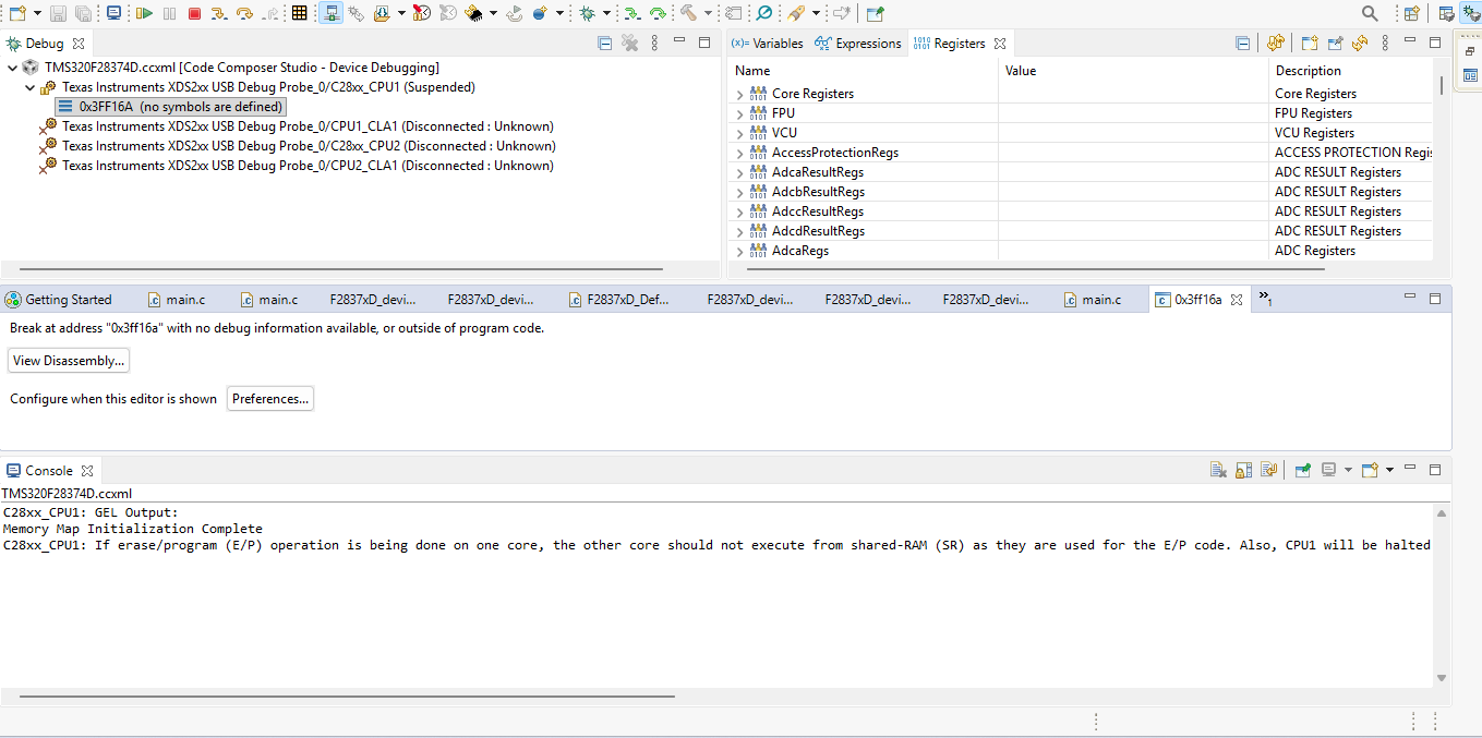

We have dessinged a TMS320F28374D based cutom controller board for a project and we are using XDS200 Digital spectrum for debugging and falsh operation. We are facing issues like, target is detecting wher we are trying to connect target and debugger is disconnecting when we are trying to do flash erase operation.  I have attached the screenshots for your reference.
Guide us on this.
    To confirm, the debugger disconnects only when performing a flash erase? Can you scope VDDIO, VDD, XRSn? And also measure IDDIO/IDD during flash operations?

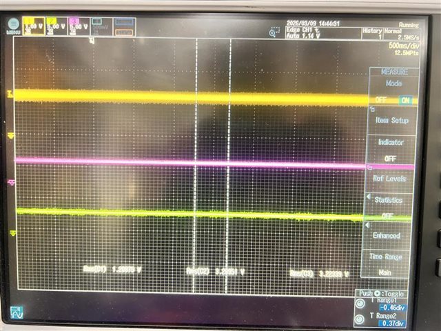

    Please find the attached images. Today we have not seen any disturbance in XRS pin, instead, there is a dip in 3.3V.
    Yellow - 1.2V,
    Pink - XRSn,
    Green - 3.3V
    After connecting with the target 1,2V became noisy and when performing erase operation 3.3V is going low and coming back.

    After clicking on flash erase, target was getting disconnected so that i couldn't monitor the RESC register value.
    The RESC register only resets on POR, so an XRSn won't clear the register values.

    We are using this TPS62420DRCR regulator to generate 3.3V and 1.2V and it can able to withstand 600mA and 1000mA. Please check the power supply circuit once.
    Please refer the below image, Yellow, 3.3V, Green 1.2V, Pink XRSn

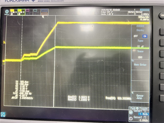

    Please look at the attached images, which are 3.3V and 1.2V
    3.3V is taking 1ms to reach from 0V after powerup. 1.2V is taking around 1.6ms to reach from 0V after powerup.
  • We have captured those things with external power supply, we will try capture with on-board regulator.
    Your supply ramp rates are 3300 V/s and 750 V/s for VDDIO and VDD, respectively. This satisfies the range of 330 - 100,000 V/s.
    However, your VDDIO and VDD are not powering up simultaneously, which causes an issue. When using the internal POR circuit, simultaneous ramping is required.
    Note that VDDOSC is a 3.3 V supply pin, and the datasheet says the below:
    VDDOSC and VDD must be powered on and off at the same time. VDDOSC should not be powered on when VDD is off. For applications not powering VDDOSC and VDD at the same time, see the "INTOSC: VDDOSC Powered Without VDD Can Cause INTOSC Frequency Drift" advisory in the TMS320F2837xD Dual-Core MCUs Silicon Errata
    Also: VDDIO, VDDA, VDD3VFL, and VDDOSC must stay within 0.3V of each other during operation
    The above implies that VDD should ramp along with 3.3 V.

  • Hello Stevan,
    Please find the attached image, we made the power supply to reach 3.3V & 1.2V within the time limit, But still the erase and flash operation is failing.
  • Hello Vasu,
    What are the new supply ramp rates? Couple of notes:
    - Before powering the device, no voltage larger than 0.3 V above VDDIO can be applied to any digital pin, and no voltage larger than 0.3 V above VDDA can be applied to any analog pin (including VREFHI).
    - The 3.3-V supplies should be powered up together and kept within 0.3 V of each other during functional operation.
    - During the ramp, VDD should be kept no more than 0.3 V above VDDIO.
  • Hello Stevan,
    The ramp rate 2750 V/S. which means it reaching 3.3V in 1.2ms.
    We have not connected any circuits to digital IO and analog pins, all are open.
    VERFHI is connected to 3.3V which is connecting to VDDIO through bead inductor.
    Yes we powered up 3.3V and 1.V together.
    Yes VDD supply is below VDDIO supply and you can refer above image yellow (3.3V) is higher than green (1.2V).
