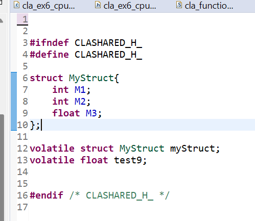

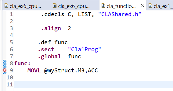

when I use try to use struct in the .asm file for CLA, the below error happens:
[E0300] The following symbols are undefined
The .asm file be like
and the header be like:
The project is attachedtestCode.zip

  • Please read this FAQ (not from TI) and get a clear understanding of the terms definition and declaration.
    These lines from CLAShared.h ...
    volatile struct MyStruct myStruct;
    volatile float test9;
    ... are definitions of the variables.  In a header file, this is very unusual.  If you include this file in more than one place, that defines those variables multiple times, and causes an error at link time.  To change them from definitions to declarations, add the keyword extern ...
    extern volatile struct MyStruct myStruct;
    extern volatile float test9;
    This change also fixes the problem with the assembly file referring to these types through .cdecls.
