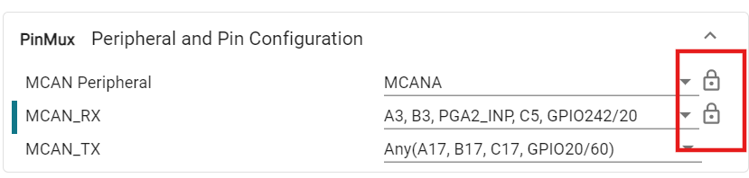

TMS320F28P550SJ: Syscfg "lock" feature confusion
Part Number: TMS320F28P550SJ
Hi Experts,
I am using syscfg to configure the pinmux for MCAN, there is a lock icon in the pinmux, but it's function is confusing.
When it's "locked", I can still change the settings. When unlocks, the value returns to "Any", as it says in the description.
Looks like this is a "reset" instead of "lock"
Is it a bug or feature? If it's feature what's the point of this function?
Hang
  • Hi Hang,
    Let me loop pinmux experts on this.
    Aswin
    The function of the Lock feature is to lock the given pinmux configuration for a pin or peripheral, such that if another peripheral (or even another MCAN instance) is added, the SysConfig solver doesn't automatically go ahead and change the pin configuration to avoid pinmux conflicts. When "Any" is selected, this means that there are no hard requirements for peripheral pinmuxing i.e. the solver can change the pin configuration as needed.
    When "Unlock" is selected, this returns the pin/peripheral selection to "Any". This allows the solver in SysConfig to find new pinmux combinations that fit the peripheral requirements as configured by the user.
    Matt
  • Hi Matt,
    Understood.
    Though I'd like to suggest that not returning the "any" when "unlock" is selected. Customer may mistaken the lock as "locking and setup so user won't chang it accidently" and plays with the lock icon, which is inevitable, but, we can avoid this behavior destroying their existing configuration.
