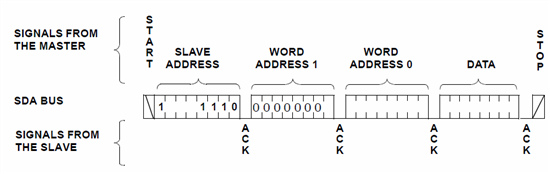

According to the spec it has the same write protocol as the eeprom on ezdsp...

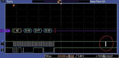

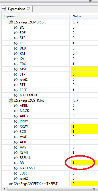

After a write my scope show that the transaction takes place with the slave address, 3 data bytes, appropriate acks and the stop condition. In addition the SCD bit in I2caRegs.I2CSTR shows that a stop condition has been detected this is consistent on both the ezdsp eeprom and eeprom on our custom board.
My problem, presumably, is that after the send the bus busy bit is set though a stop condition has been detected per the SCD bit. Also, there is a strang series of clock pulses (see circled above) following the write though another write operation has not been requested.
Can anybody provide some insight as to what I might be misconfiguring?
