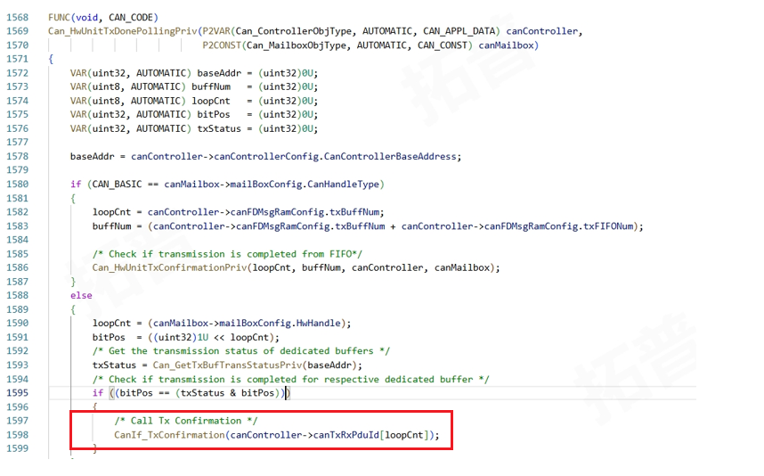

Hi team,
I ask this for my customer.
My customer find MCAN_TXBTO will be set after it finish the transmit message, and will not be cleared.
So the CanIf_TxConfirmation will be called after it transmit one message.
Could you help to check is it normally?
