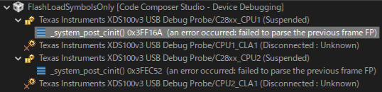

Issue:
When DCSM is enabled (SBL + APP + DCSM), the system does not start.
When debugging the CPU1 SBL with the CCS debugger, execution stops at:
_system_post_cinit() [stop address] (an error occurred: failed to parse the previous frame FP")
Execution does not reach the main() function of the CPU1 SBL.

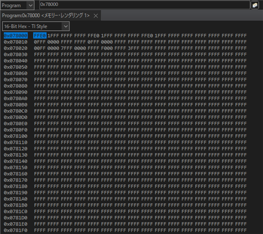

CPU1
SBL
main()
#include "key.h"
#define BRANCH_APP  "    LB 0x084000"
void main()
    GenerateKey();
    asm(BRANCH_APP);
dcsm.asm
; Zone 1
     .sect "dcsm_otp_z1_linkpointer"
      .retain
      .long 0x1FFFFFFC
      .long 0xFFFFFFFF     ;Reserved
      .long 0x1FFFFFFC
      .long 0x1FFFFFFC
     .sect "dcsm_otp_z1_pswdlock"
      .retain
      .long 0xFFFFFFF0
     .sect "dcsm_otp_z1_crclock"
      .retain
      .long 0xFFFFFFFF
     .sect "dcsm_otp_z1_jtaglock"
      .retain
      .long 0xFFFFFFFF
;;     .sect "dcsm_otp_z1_bootctrl"
;;      .retain
;;      .long 0xFFFFFFFF     ;Reserved
;;      .long 0x49550B5A
     .sect "dcsm_zsel_z1"
      .retain
      .long 0x000000FF       ;Z1-EXEONLYRAM
      .long 0x00003FFF      ;Z1-EXEONLYSECT
      .long 0x3000F555          ;Z1-GRABRAM  - LS0-5 RAM Secured
      .long 0x0FFF5555         ;Z1-GRABSECT - FLASHA-H Secured
      .long 0xFFFFFFFF  ; Confidentiality
      .long 0xFFFFFFFF
      .long 0xFFFFFFFF
      .long 0xFFFFFFFF

   DCSM_OTP_Z1_LINKPOINTER   : origin = 0x78000, length = 0x00000C
   /* Z1 OTP.  GPREG1/GPREG2 */
   DCSM_OTP_Z1_GPREG         : origin = 0x7800C, length = 0x000004
   /* Z1 OTP.  PSWDLOCK/RESERVED */
   DCSM_OTP_Z1_PSWDLOCK	    : origin = 0x78010, length = 0x000004
   /* Z1 OTP.  CRCLOCK/RESERVED */
   DCSM_OTP_Z1_CRCLOCK	    : origin = 0x78014, length = 0x000004
   /* Z1 OTP.  RESERVED/JTAGLOCK */
   DCSM_OTP_Z1_JTAGLOCK	    : origin = 0x78018, length = 0x000004
   /* Z1 OTP.  RESERVED/BOOTCTRL */
   DCSM_OTP_Z1_BOOTCTRL	    : origin = 0x7801C, length = 0x000004
   /* DCSM Z1 Zone Select Contents (!!Movable!!) */
   /* Z1 OTP.  Z1 password locations / Flash and RAM partitioning */
   DCSM_ZSEL_Z1_P0	        : origin = 0x78020, length = 0x000010
   /* Z2 OTP.  LinkPointers */
   DCSM_OTP_Z2_LINKPOINTER	: origin = 0x78200, length = 0x00000C
   /* Z2 OTP.  GPREG1/GPREG2 */
   DCSM_OTP_Z2_GPREG	        : origin = 0x7820C, length = 0x000004
   /* Z2 OTP.  PSWDLOCK/RESERVED */
   DCSM_OTP_Z2_PSWDLOCK	    : origin = 0x78210, length = 0x000004
   /* Z2 OTP.  CRCLOCK/RESERVED */
   DCSM_OTP_Z2_CRCLOCK	    : origin = 0x78214, length = 0x000004
   /* Z2 OTP.  RESERVED/JTAGLOCK */
   DCSM_OTP_Z2_JTAGLOCK	    : origin = 0x78218, length = 0x000004
   /* Z2 OTP.  GPREG3/BOOTCTRL */
   DCSM_OTP_Z2_BOOTCTRL	    : origin = 0x7821C, length = 0x000004
   /* DCSM Z2 Zone Select Contents (!!Movable!!) */
   /* Z2 OTP.  Z2 password locations / Flash and RAM partitioning  */
   DCSM_ZSEL_Z2_P0	        : origin = 0x78220, length = 0x000010
#endif	/* _USE_BOOT_LOADER */

#ifdef _USE_BOOT_LOADER
// DCSM Configuration
   dcsm_otp_z1_linkpointer 	: > DCSM_OTP_Z1_LINKPOINTER		PAGE = 0
   dcsm_otp_z1_pswdlock		: > DCSM_OTP_Z1_PSWDLOCK		PAGE = 0
   dcsm_otp_z1_crclock		: > DCSM_OTP_Z1_CRCLOCK			PAGE = 0
   /* F28379D JATGLOCK Not supported */
    dcsm_otp_z1_jtaglock    : > DCSM_OTP_Z1_JTAGLOCK        PAGE = 0, type = DSECT
   dcsm_otp_z1_bootctrl		: > DCSM_OTP_Z1_BOOTCTRL		PAGE = 0, type = DSECT
   dcsm_zsel_z1				: > DCSM_ZSEL_Z1_P0				PAGE = 0
   dcsm_otp_z2_linkpointer	: > DCSM_OTP_Z2_LINKPOINTER		PAGE = 0, type = DSECT
   dcsm_otp_z2_pswdlock		: > DCSM_OTP_Z2_PSWDLOCK		PAGE = 0, type = DSECT
   dcsm_otp_z2_crclock		: > DCSM_OTP_Z2_CRCLOCK			PAGE = 0, type = DSECT
    dcsm_otp_z2_jtaglock    : > DCSM_OTP_Z2_JTAGLOCK        PAGE = 0, type = DSECT
   dcsm_otp_z2_bootctrl		: > DCSM_OTP_Z2_BOOTCTRL		PAGE = 0, type = DSECT
   dcsm_zsel_z2				: > DCSM_ZSEL_Z2_P0				PAGE = 0, type = DSECT
    Do you mean that CPU1 fails to boot to flash (i.e. SBL) from the Boot ROM?

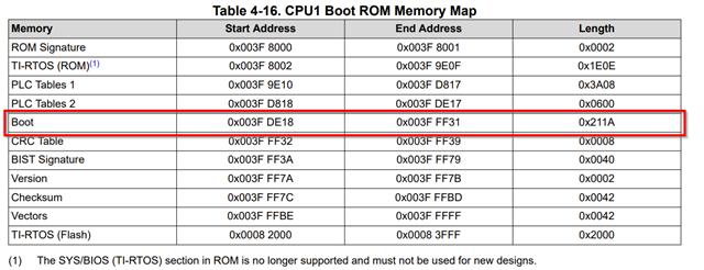

    Address 0x3FF16A for CPU1 is located in the CPU1 Boot memory range:
    Can you load the Boot ROM symbols to see where the device is getting stuck? Please refer to Section 5.3 in SPRUJH3 for steps on how to do that.
    Note that address 0x3FEC52 for CPU2 means that it is stuck in Idle mode, in the Boot ROM.
    Yes, that is correct.
    When DCSM is enabled, CPU1 does not successfully boot to the SBL in flash.
    Instead, when I start debugging with CCS, execution stops at:
    _system_post_cinit() 0x3FF16A (an error occurred: failed to parse the previous frame FP")
    and it does not reach the main() function of the CPU1 SBL.
    When DCSM is disabled, the system boots correctly and the CPU1 SBL runs as expected.
    Therefore, it seems that the issue only occurs when CPU1 DCSM is enabled.
    Following your suggestion, I loaded the Boot ROM symbols (referring to Section 5.3 of SPRUJH3) and checked where the device is stopping in the Boot ROM.
    I have attached a screenshot of the disassembly around 0x3FF16A.
    Could you please help identify what might be causing the device to stop at this location?

    Looking at your CPU1 dcsm.asm and SBL linker command file:
    .sect "dcsm_otp_z1_linkpointer" .retain .long 0x1FFFFFFC .long 0xFFFFFFFF ;Reserved .long 0x1FFFFFFC .long 0xFFFFFFFF ;Reserved .long 0x1FFFFFFC .long 0xFFFFFFFF ;Reserved
    Any reason why the link pointer is set to 0x1FFFFFFC and not 0x1FFFFFFF? Since you've decremented the link pointer twice, you'll have to offset the Zone Select Block (ZSB) by 0x40. You still have the ZSB offset by 0x20 (starting at 0x78020) for the default link pointer (0x1FFFFFFF)
    In other words, for a link pointer of 0x1FFFFFFC:

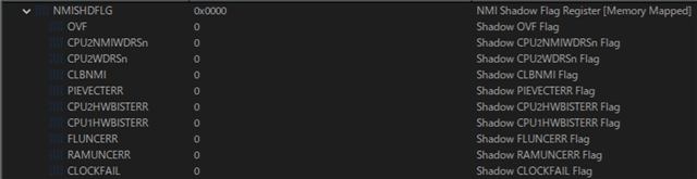

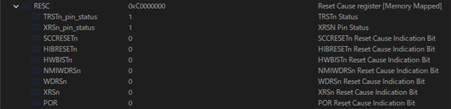

    To also rule out other issues: can you check the value in RESC register and NMISHDFLG?
    I had assumed that both the LINKPOINTER and the ZSB offset were defined within dcsm.asm.
    Regarding dcsm.cmd, it is generated from dcsm.syscfg with "include build: OFF" and placed under an "excluded" folder.
    However, since its contents are manually copied into the main linker command file, the generated dcsm.cmd itself is excluded from the build.
    This is intentional to separate development and production configurations, and to avoid unintended DCSM settings during development.
    I will align the LINKPOINTER and ZSB location and need some time to verify the behavior.
    I checked the RESC and NMISHDFLG registers.
    All reset status bits in RESC are 0, and all NMISHDFLG bits are also 0.
    This indicates that no reset source or NMI-related error has occurred.
    Therefore, it seems that the issue is not caused by a reset or hardware fault.
    The ZSB offset is handled in dcsm.cmd with DCSM_ZSEL_Z1_P0 origin address while the link pointer value is handled in dcsm.asm. Usually this is handled automatically by SysConfig, but given the contents were manually copied that wouldn't happen.
    Please let me know what behavior you observe with the changes.
    Thank you for confirming that with me, that is good to rule out.

  • Hello, Matt
    I apologize for the late reply.
    After correctly configuring the address (origin) of DCSM_ZSEL_Z1_P0, the Secondary Bootloader (SBL) and Application (APP) are now able to operate in coordination.
    However, the following issues remain:
    Issue 1:
    Even when DCSM is configured, the FLASH contents are still visible during debug execution.
    Issue 2:
    An error occurs when attempting to program SBL.out + APP.out including DCSM using UniFlash.
    (This issue has been present since the early stage.)
    As a workaround, after the error occurs, SBL.out + APP.out without DCSM are programmed.
    Based on the UniFlash console log, the LinkPointer appears to advance by 0x10, which suggests that DCSM programming may have been performed.
