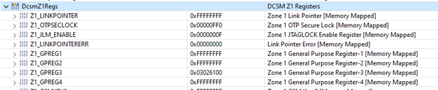

    With serial_flash_programmer.exe i have done sci booting in EMU
    i have changed the default SCI pin to GPIO42 and 43
    so i have written 0x61
    This is working
    so i tried in OTP by writing gpreg3 with 0x03026100
    it has programmed successfully
    but sci default pins are not changed to GPIO42 and 43
    so i have tried to change the GPREG1 register with 5AFF4854
    it is not programming
    what should i do to change the SCI default pin to gpio42 and 43.
    Any Suggestions or guidlines would be appreciated.
    Thanks in advance!
    Ranjith
    If you wish to program non-default boot configurations in the OTP, you need to program both GPREG1 (BOOTPIN-CONFIG) and GPREG3/4 (BOOTDEF-LOW/BOOTDEF-HIGH). Programming GPREG1 is necessary since the 0x5A key in the upper 8-bits indicates to the Boot ROM that OTP boot configs are programmed. For more details, please refer to Chapter 2.1 Standalone Boot in SPRUJH3.
    What is the value in GPREG1 (0x78008) in memory?
    Matt
    Thanks for the reply,
    starting i haven't changed  gpreg1
    so it was 0xFFFFFFFF while programming
    but after that i have changed and tried with 0x5AFF4854 but it was not programming
    Thanks in advance!
    Ranjith
    Are you unable to in CCS with the On-Chip Flash tool? Do you have other F28P65x units to test if you can program both GPREG1 and GPREG3 at the same time?
    Matt
    only GPREG1 and GPREG3 is sufficient
    i will write 0x5Aff4854 in GPREG1 and 0x03026100 in GPREG3
    is this ok or not
    Thanks in advance!
    Ranjith
    Yes, that looks good. Please ensure only BMSP0 (GPIO84) is '1' to select SCI boot (0x61).
    Matt
