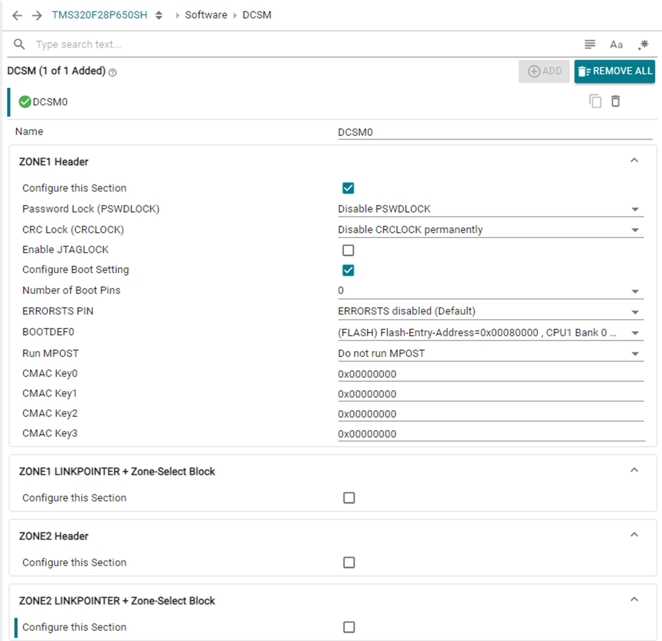

Environment:
CCS 12.8.1
C2000ware V6.0
Sysconfig V1.25
Uniflash 9.3.0

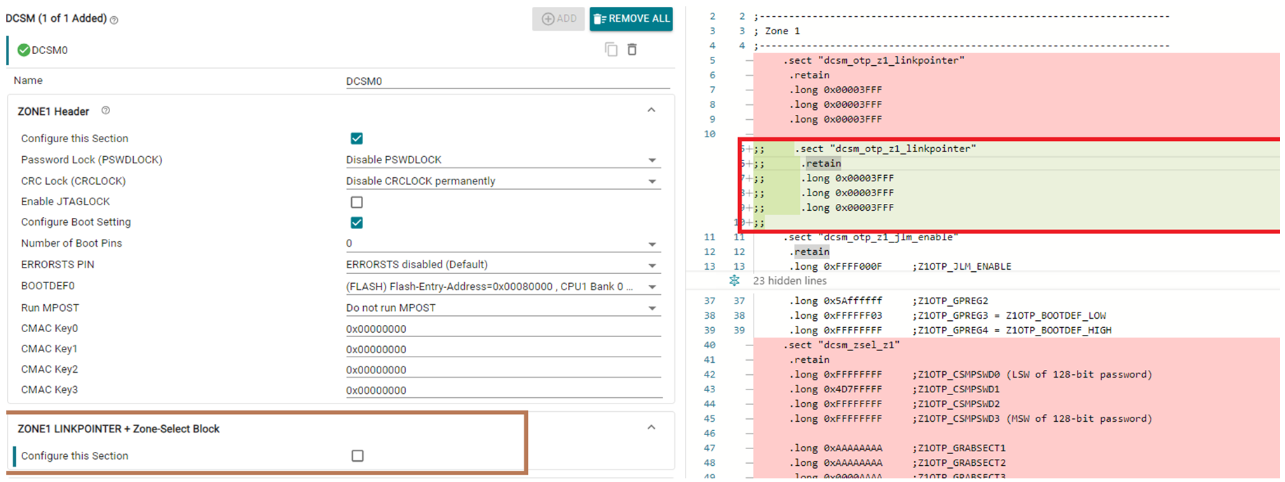

They use Sysconfig/DCSM to generate dcsm.asm/cmd files, and the setting is shown below.
However, they got errors below when programming on CCS 12.8.1 and Uniflash 9.3.0 even with a new device (new OTP for the first-time programming).
It seems there is something wrong when programming DCSM_OTP_Z1_LINKPOINTER where they don't touch in Sysconfig/DCSM.

  • Hi Wayne,
    Does the same error occur when you comment out the Z1OTP_JLM_ENABLE lines in dcsm.asm? You can copy dcsm.asm/dcsm.cmd over and remove the DCSM module in SysConfig so the files don't get overwritten.
    Can you also send a screenshot of values at address 0x78000 - 0x78020 in the CCS memory browser?

  • Hi Matt,
    The user has verified this error does not occur if they comment out lines 11-13 below as you asked.
    This is the memory dump for 0x78000 - 0x78020.
    Would you please update/fix Sysconfig to generate the right codes accordingly?

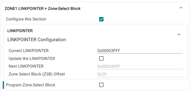

  • Hi Wayne,
    Thank you confirming that for me. Since all OTP locations except the link pointers and JLM_ENABLE locations being protected with ECC, there must be some unintended behavior when only JLM_ENABLE (and not the link pointer) is being programmed (even if with default values).
    Can you recommend the following workaround (verified on my setup Slight smile):
    1. Enable configuration of the ZONE1 LINKPOINTER + Zone-Select Block section
      1. Do NOT select "Update the LINKPOINTER" or change the current (default) LINKPOINTER value
    2. Disable "Program Zone-Select Block"
    This effectively uncomments only the link pointer configuration lines (with the default link pointer values). Thus, the ZSB, JLM_ENABLE, and link pointers won't be programmed and will unblock the customer's the original issue.
