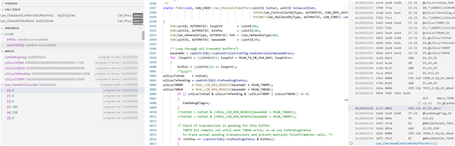

    Thank you for your feedback. I would like to clarify a few points regarding my use case:
    #1 - Calling Can_Write in a task: This approach will probably work but is not a viable solution for my application, as it would severely limit the CAN bandwidth. While my example only involves 3 segments, the actual implementation can have significantly more.
    #2 - Relevance of the data byte: The specific data byte used in the example is not relevant to the application itself. It is simply there to demonstrate the anomaly: without the fix, the system generates up to 5 confirmations for 3 transmitted frames. With the fix applied, it correctly generates exactly 3 confirmations for the 3 frames.
    Regarding your question: "During your debugging have you observed TXBTO and (TXBAR or TXBRP) set at the same time?"
    Yes, absolutely. Observing this exact condition is the reason for implementing the fix in Can_CheckAllTxBuffers.
    To verify this behavior, I added a diagnostic counter within Can_CheckAllTxBuffers for this specific condition, and I can confirm that the counter does indeed increase.
    Since a CAN frame with a high ID cannot access the CAN bus while a frame with a lower ID is transmitting, delays and collisions are expected during high-rate transmissions.

    I would like to bring a specific technical scenario to your attention regarding the Can_CheckAllTxBuffers function.
    Can_CheckAllTxBuffers to parse the copy of the MCAN_TXBTO register (txStat) using a for-loop that iterates from LSB to MSB, covering the mailboxes for frames 0x20 through 0x23..
    If a request made by my pseudo-task for 0x23 is pending, the notification for the last segment of frame 0x21 triggers a new transmission request for 0x23.
    This action sets the corresponding bits in MCAN_TXBRP and txPendingStatus via Can_Write.
    While it successfully clears the bit in the hardware MCAN_TXBTO register, the local copy (txStat) used by the loop is not updated.
    As a result, this bit is tested in the next iteration of the same loop using the stale value, which incorrectly triggers a TX confirmation notification for frame 0x23.
    This scenario only requires at least segment of 0x23 has been previously send (setting the corresponding bit in MCAN_TXBTO).
    Find enclosed the CCS workspace I used.
    - When we enter in ISR, we save the status registers and use the same status throughout the ISR. If the status is changing after capturing, that will be processed in next ISR.
    - In ISR of 0x21, BTO for both 0x21 and 0x23 is set
    - During TxConfirmation of 0x21, a new message transmission for 0x23 is initiated. Please note that, at this point the old message on 0x23 is already sent by hardware and we must receive the confirmation of the old transmission as well. When new transmission for 0x23 is initiated, BAR then BRP then BTO will sequentially set and will be processed in subsequent ISR.
    -New message is accepted because the hardware buffer is ready to transmit the new message. Old message was transmitted successfully only the confirmation is pending.
    - This is expected because the old tx message was actually sent out by hardware and hence user must receive the confirmation for it.
    - This notification is correct as 0x23 message was actually sent out by hardware.

    If it makes it clearer a frame 0x22 could be transmitting while 0x23 is waiting for the bus.
    My point is I send a frame 0x23  using Can_write during the notification of the frame 0x21.
    Therefore I expect a notification for this new frame after 110µs (at 1000Mbps).
    txStat is not cleared (since the last correct notification of 0x23) by this new frame and will not be until the next ISR.
    txPendingStatus has been set immediatly by Can_write.
    The current iteration of the for-loop manages frame 0x21 then the next iteration will manage the frame 0x22 and the next one the frame 0x23.
    As (bitPos == (canCntrlObj->txPendingStatus & bitPos)) and (bitPos == (txStat & bitPos)) are true, this new iteration will call the notification for frame 0x23 even if it is not sent yet.
    In this notification I'm supposed to be able to send the new frame segment of frame 0x23 as this notification is supposed to be called only when the frame TX is completed.
    However, since the transmission is not actually complete, the mailbox remains busy, and the operation fails.

    Now we fully understand the use case and the issue of stale snapshot. The workaround that you proposed earlier will solve the issue without any side effects.
    txStat = txStat & (~MCAL_LIB_REG_READ32(baseAddr + MCAN_TXBAR));
    txStat = txStat & (~MCAL_LIB_REG_READ32(baseAddr + MCAN_TXBRP));
    This issue will only happen in interrupt mode, no update necessary for polling.
    We will continue to do thorough testing with this fix and let you know if there is any change in fix.
    The fix will be included in 26.00.01 release targeted by end of June.
