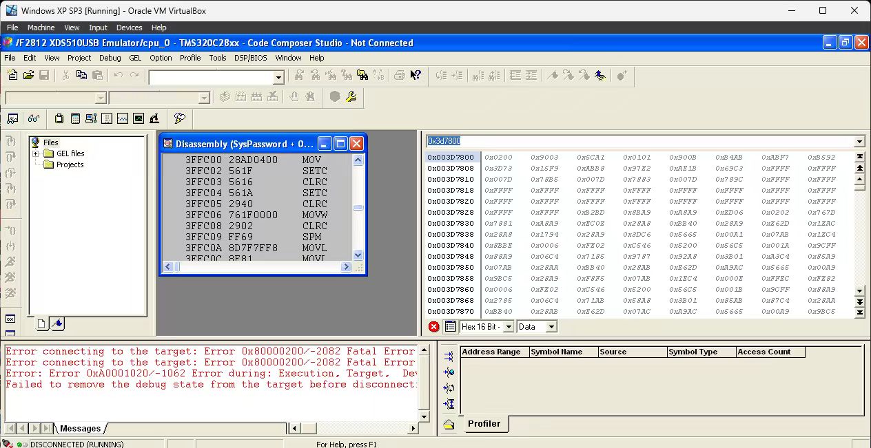

When I was writing the program, the error message shown in the picture appeared. Is this because the OTP in the chip is locked? How should I deal with it?

Did you program the CSM passwords? If so, you won't be able to read the OTP memory contents without unlocking the device.
