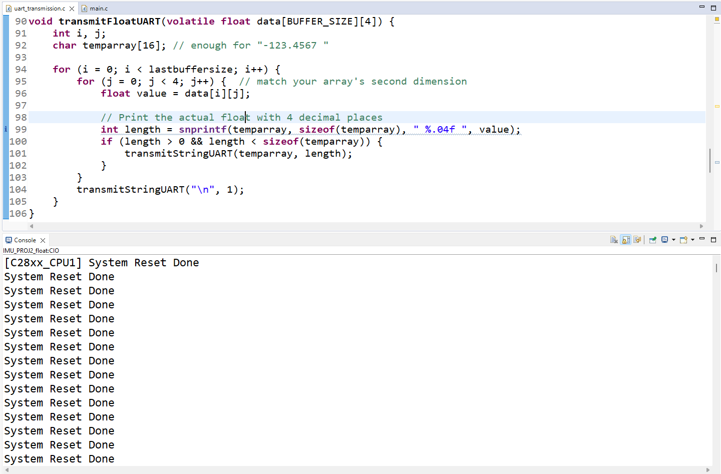

I am working with a C2000 device ([TMS320F28379D]) and using the SCI (UART) peripheral for serial communication.
Initially, I verified that SCI transmission is working correctly by sending normal strings. I was also able to convert integer values to strings and transmit them successfully.
After that, I tried to transmit floating-point values by first converting them into strings using sprintf and then sending them over SCI.

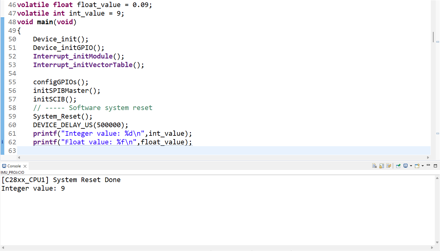

However, when I did this, I started observing abnormal system behavior. To isolate the issue, I then tried a simpler test by just printing the float using printf:
But even this did not work correctly. The output is empty, whereas the same is working fine for integer values.

    I am using printf to print a float value in the CCS console, and I have included the stdio.h library. The project also utilizes the UART protocol for data transmission. The SCI peripherals code is adapted from the examples in the C2000ware SDK.I have verified that the predefined symbol is correctly defined in the project; however, the issue still persists.
    Could you kindly suggest a solution or provide guidance on why printf and snprintf might not be displaying and transmitting float values correctly over UART?

  • Hi Deepan,
    Can you show the console output you get? As I mentioned before, the printf() does not use the SCI module on the chip. It uses JTAG to print through the debugger interface.
    Can you check your compiler setting for the --printf_support flag? This should be set to --printf_support=full to send floats. See documentation here.

    Yes, I have already checked my compiler settings and confirmed that the --printf_support flag is set to full.
    However, I am still facing an issue where float values are not being printed in the console output. Even when I try printing a simple float value using printf, nothing appears in the console (screenshots attached).
    I am also experiencing a related issue when attempting to transmit float values as strings over UART (using snprintf). I have attached screenshots of the console output for both issues in my previous message.

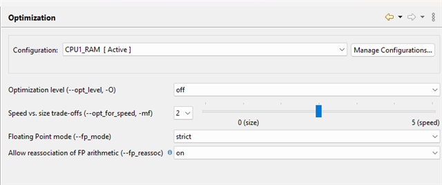

    • Can you check your map file to see which library is being used for the printf calls?
    • Can you try building your project with no optimization? High optimization levels may remove or inline the printf calls.
    Delaney
    Apologies for the delayed response.
    The library currently being used for the printf calls is rts2800_fpu32_eabi.lib. And I also attempted to build the project with optimization disabled, but the issue persists—float values are still not being printed correctly.

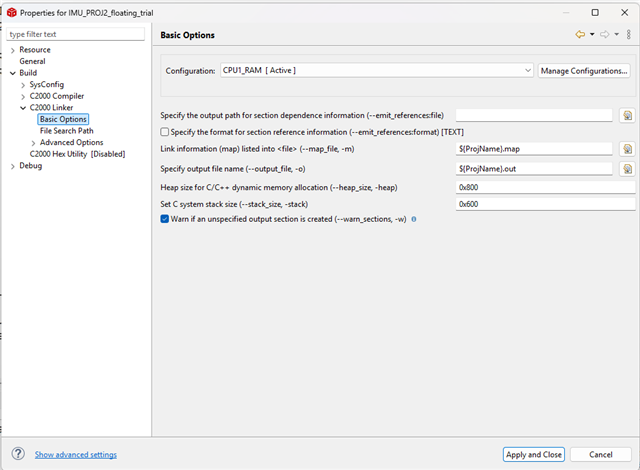

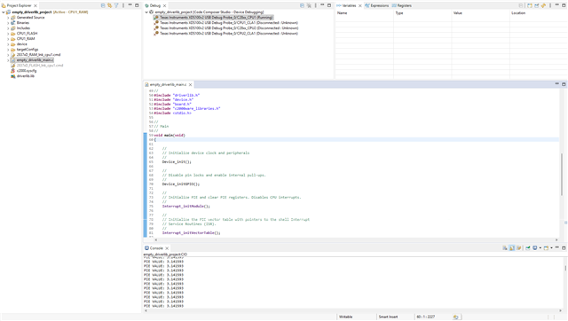

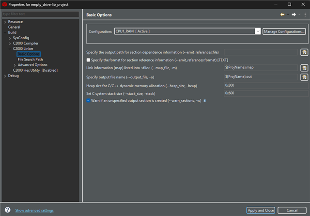

    Apologies again for the delay. I was able to get printf() and snprintf() working with a float on my setup. I had to increase both my stack size and heap size quite a bit, current values are below:
    This also required some modifications to the linker cmd file to allocate more memory to the sections where the heap and stack are placed. Below is my code, please try this on your setup and let me know if you run into any issues.
            char temparray[16];
            float value = 3.14159265f;
            int length = snprintf(temparray, sizeof(temparray), " %.04f", value);
            printf("PIE VALUE: %f\n", value);
    Delaney
    I’ve tried running the code with the same settings you suggested.
    1. I updated the heap and stack sizes as you recommended (screenshot attached).
    2. I also increased the memory allocation in the linker command file (please correct me if this is not the right approach).
    Even after applying these changes, I’m still not able to see the float value printed in the console.
    Could you please help me understand what might still be missing?
    Thank for your support in advance.

  • Hi Deepan,
    Here is the project I used:
    5518.empty_driverlib_project.zip
    Can you try this out and let me know if it works on your setup?
    Delaney

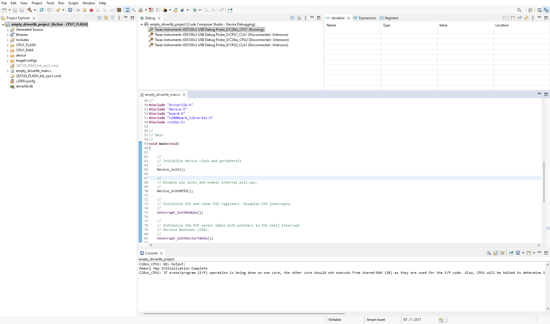

    I tested the project you shared, and it works correctly when I use the CPU_RAM build configuration.
    However, when I switch to CPU_FLASH (which I need in order to flash the build onto the board), I still encounter the same issue as before during debugging.
    I also tried the same setup with my own code where a float value is sent over UART. The issue is the same there as well: in CPU_RAM, the data is received correctly during debugging, but in CPU_FLASH, no data is received at all—even when flashing and debugging the build. We are using Tera Term to monitor the UART output.
    Let me know if you have any suggestions on what could be causing this difference between RAM and FLASH builds.

  • Hi Deepan,
    That is odd, let me test the flash build myself and get back to you. I'm assuming the flash build somehow still isn't allocating enough heap or stack space.

  • Hi Deepan,
    Unfortunately, I still haven't had a chance to try the flash build myself. If you try allocating a lot more heap or stack space does it fix the issue?
    Delaney
    I tried increasing the heap and stack sizes in the project properties, and I also modified the Flash linker .cmd file. However, despite these changes, I was still unable to get floating-point values to print correctly in the console.
    I have attached the screenshot of the output:
    Could you please let me know if there are any additional steps or configurations, I should try to resolve this issue?
    Thank you in advance for your support.
    Deepan
    Following up on my previous post regarding the floating-point printf issue in the Flash build.
    I wanted to check if there are any further suggestions or recommendations on additional configurations I could try to resolve this issue. And could you please confirm whether you are able to print floating-point values correctly in the console when using a Flash build on your end?
