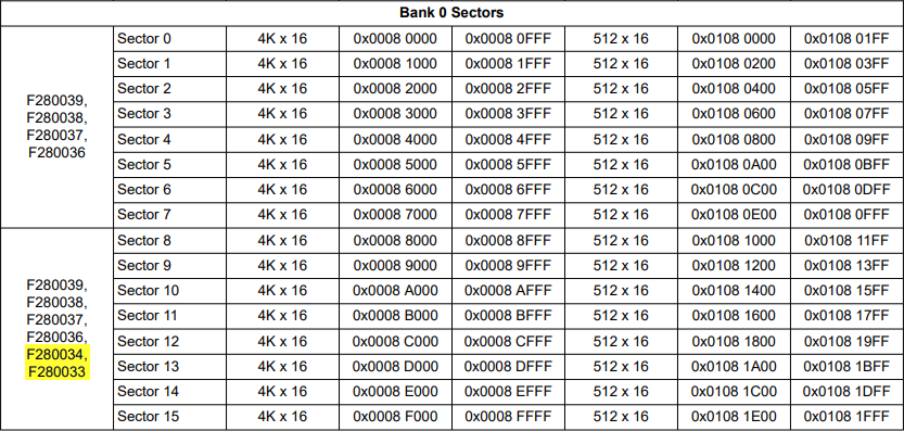

The default boot to flash entry point is 0x80000 in the F28003x Boot ROM, which is not in the memory map for the F280033/F280034 subset parts. This thread will detail how to modify the boot to flash entry point to 0x88000 for F280033 and F280034 devices by programming the DCSM OTP.

    1. The device can be configured for the default boot to flash (to 0x80000) and still be able to successfully program the new configurations, despite 0x80000 not being in F280033/F280034's memory map.
    2. Please confirm that the application's linker command file is modified to account for the subset flash memory maps. In particular, the codestart for the application must be at the flash entry point for the configured flash boot mode.
