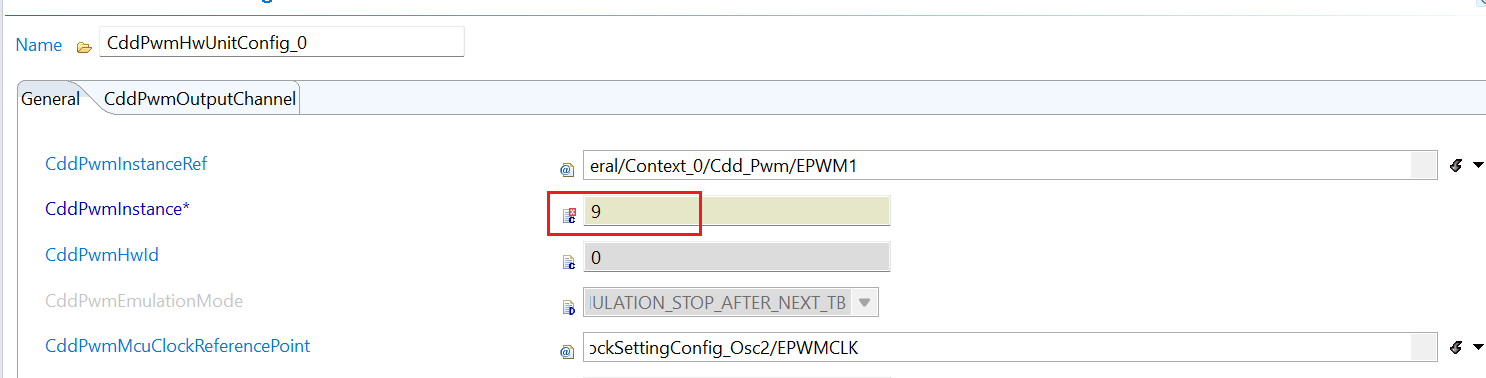

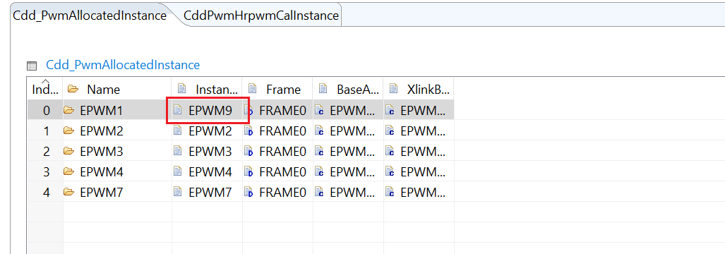

Customer want to know why they can't select EPWM9 in MCAL? they use F29H85xMCAL-01.04.01.02

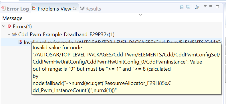

Hi Shuqing,
This is a bug in the MCAL 1.4.1
This has been fixed at our end and would be part of the next release.
It is an error in the logic of the check.
You can find this fix in the intermediate release as well.
