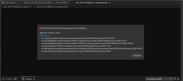

My cusomter has a syscfg file that needs migration
When they use C2000WARE 26.0 and syscfg1.27, they have below error when clicking the "Switch" buttion to switch devices.
If they switch back to C2000WARE 4.3 and syscfg 1.16, there would be no issue.
What's the issue here?
Hang
  • This may have something to do with network.Customer do not have internet access, and they have this issue. I can not reproduce this issue since I have network issue.
    Could you please help confirming this as well?

  • Hi Ira,
    I've reproduce this under syscfg1.27 and c2000ware 26, the outcome is different to customer but it shows that the migration has something to do with network.
  • One more update,
    I am reproduce the same outcome as customer, just by switching to C2000ware 6.0 + syscfg 1.27
    Make sure you disconnect the internet to reproduce this issue.

  • Hi Hang,
    I tried to reproduce your issue on my end with CCS 20.5 and Sysconfig 1.27
    I imported a F280037 Project and launched the sysconfig gui.
    1. With internet on : When I click on SWITCH the migrate settings window pops up and everything works fine.
    2. With internet off : When I click on SWITCH I get the following error
    Oh Snap! The last change caused an exception...
    TypeError: Failed to fetch
    at o (localhost:53348/.../ui.js:1006:41352) at t.getTICOMData (localhost:53348/.../ui.js:1006:41721) at t.createMigrationOptions (localhost:53348/.../ui.js:946:79098) at localhost:53348/.../ui.js:896:12331 at t.ModalService.showProgressDuring (localhost:53348/.../ui.js:1007:6974) at http://localhost:53348/ccs-webview/sysconfig_JomL0Dp6Xw54YEnT/ui.js:942:20449
    Is this what you see as well?
  • Ira,
    Lett's say yes.
    I think what you see is almost the same to my screen shot, with a few differences in the port number, which indeed may varies among difference machines.

  • 1. With internet on : When I click on SWITCH the migrate settings window pops up and everything works fine.
    yes, I can reproduce this issue too. I will bring this thread to the attention of the sysconfig experts.
    ki
  • yes, I can reproduce this issue too. I will bring this thread to the attention of the sysconfig experts.
    A ticket has been filed for this issue. Tracking link: https://sir.ext.ti.com/jira/browse/EXT_EP-13369
    ki
  • Hi Ki,
    Seems that the fix would be released in the next update of syscfg. Is there any chance we can get a patch soon instead of waiting for the next update?
    Hang
  • Hi Hang,
    The team here is looking into it.
    ki
  • Hang, we have a beta build of 1.28 available the customer can try. Again please make sure the customer understands that this is a beta build. I will share the link to you separately.
