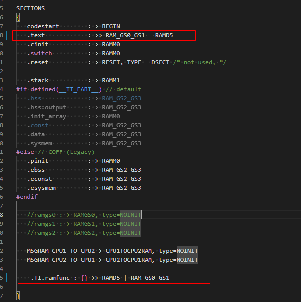

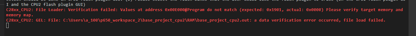

I am developing a dual-core project on the TMS320F28P650DK. When I try to load the CPU2 binary into RAM via CCS, I get the following verification error:
The project **compiles without any errors**, but the load/verification step fails at address `0x00E000`, which corresponds to the start of **D5RAM**.

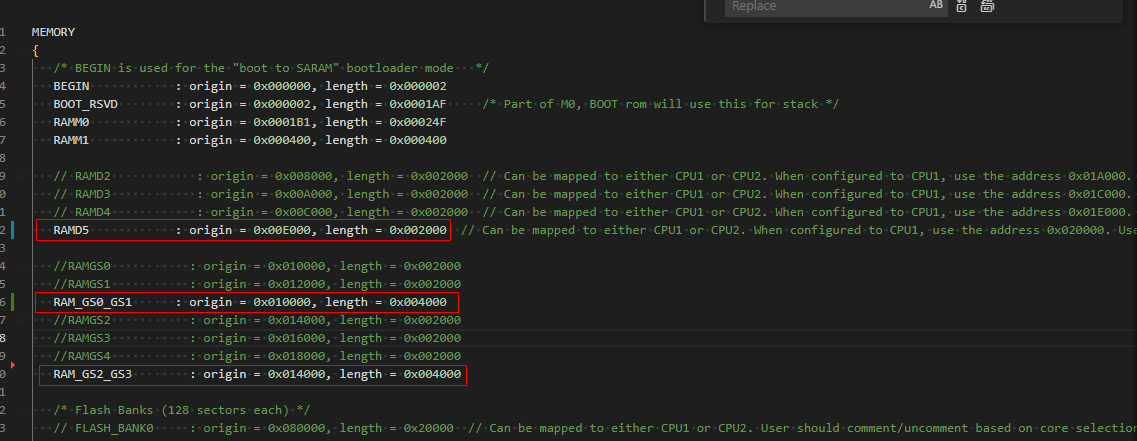

## Memory Configuration
**Linker Command File (CPU2) — MEMORY section:**
**Linker Command File (CPU2) — SECTIONS:**

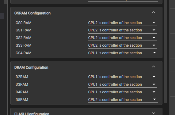

**SysConfig (CPU1) — RAM Ownership:**
The SysConfig memory ownership matches the linker allocation — D5RAM is assigned to CPU2.
