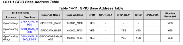

I am trying to achieve SD Card logging using CPU2 on the F28P65x core - the key objective is to write a simple message to a blank text file.
I have succeeded to use the TI example 'sd_fat32_exfat.c' to write a simple message to a blank text file (using CPU1).
I have also succeeded to follow the dual CORE examples: 'led_ex1_c28x_dual_blinky_cpu1.c' and 'led_ex1_c28x_dual_blinky_cpu2.c'.
My understanding is that CPU2 needs to be booted up by CPU1 - so my approach so far has been to modify the dual LED example by keeping the bootup logic but copying over the SD writing logic onto CPU2.
However, I always seem to get FR_NOT_READY as my returned error code when i attempt f_open(). I know my pinMux is correct, as I have successfully written using CPU1.
I have attached my attempt at modifying the LED example for SD writing.

  • Hi Samuel,
    The reason you might be getting that error is due to  CPU2 not currently having ownership of the peripheral you are attempting to use. For this SD Card logging are you attempting to use the SPI peripheral?
    Kind regards,
    AJ Favela
  • Hi Favela,
    Yes, the exchange uses SPI. In the code I attached, I use the CPU1 code to assign SPI ownership to CPU2 (plus boot CPU2). Then, on the CPU2 code, I perform the SPI config and SD write logic.
    Thanks, Samuel.
  • Hi Samuel,
    Apologies for the delayed response.
    GPIO_setControllerCore function must be called via CPU1, because only it has access to modify these registers
    Let me know if you continue to face issues after making this fix.
    Arnav
  • Hi Arnav,
    I followed your suggestion but I still seem to be receiving FR_NOT_READY. I have attached my latest code (sd_card_cpu1.c and sd_card_cpu2.c)

  • Hi Arnav,
    Update: I managed to succeed to SD log using CPU2, turns out I was using a modified sdspi.c which was breaking the spi transaction!
    I will share my working code.
    Thanks all for help!
