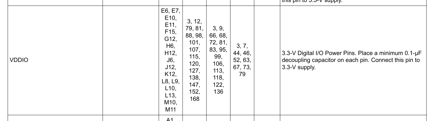

F29H859TU-Q1: What's the function of F15(VDDOSC)?
Part Number: F29H859TU-Q1
Hi team,
I ask this for my customer.
In our SOM board desgin, it shows the F15 is VDDOSC
But I can't find it in datasheet and it shows F15 is VDDIO
what's the function of VDDOSC? What's the supply current requirement of this?
BRs
Shuqing
  • Hi Shuqing,
    You are looking at the schematic? I believe this is an older altium library component where the component was taking from the F28P650 256bga footprint, so it is not the latest device specification for the F29H85. The UltraLibrarian files should have the latest spec and the schematic should be updated on the next revision of the device (I will also file a bug fix to ensure that)
    Peter
