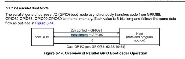

    Here are additional observations: In the TRM, parallel boot mode is described as having GPIO92 act as the host control, where pulling it low triggers the parallel boot loading sequence. However, if a valid key is not received, the device reverts to flash boot mode, which aligns closely with my findings. The core issue remains determining why the device entered parallel boot mode in the first place, given that both boot select pins (84 and 72) are high and the OTP Z1  is unprogrammed.
    0x78008 = FFFFFFFF
    0x7800a = FFFFFFFF
    0x7800c = FFFFFFFF
    0x7800e = FFFFFFFF
    z2 ->
    0x78208 = 0x5AFF4854
    0x7820a = 0x5AFFFF3F
    0x7820c = 0x00000000
    0x7820e = 0xFFFFFFFF
    I also tried EMUBOOTDEF
    BOOTPINCONFIG (0x00000D00) = 0xA5FF4854 or 0xA5FFFFFF
    CPU1EMUBOOTDEF_LOW (0x00000D04U) = 0x03UL
    However, after resetting the device, it still fails to boot from the flash, confirming that the original issue persists.
