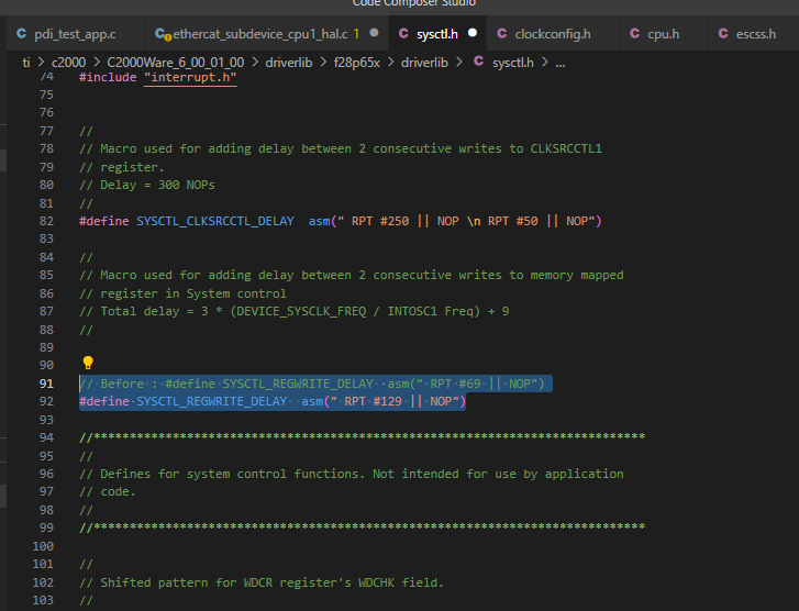

I am a user experiencing an intermittent issue where EtherCAT does not initialize properly after multiple power reboots.
This issue also occurs in the SDK example(f28p65x_cpu1_dc_eepromemu_echoback_solution), and while searching through the E2E forum, I happened to find a similar inquiry.
The link is as follows:
https://e2e.ti.com/support/microcontrollers/c2000-microcontrollers-group/c2000/f/c2000-microcontrollers-forum/1614187/tms320f28p650dk-ethercat-slave-initialization?tisearch=e2e-sitesearch&keymatch=tms320%25252520ethercat%25252520reset#
Has there been any confirmed solution to this issue?
