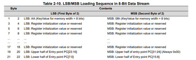

    Summary of the required data stream structure:
    1. Key value: 0x08AA (sent as 0xAA first, then 0x08—LSB first)
    2. 8 reserved words: 16 bytes of 0x00
    3. Entry point address: 32-bit (MSW first, then LSW, each word LSB-first)
    4. Data blocks: Each block has size, destination address, then data
    5. Termination: Block size of 0x0000
    Every 16-bit word must be sent LSB first, MSB second. For the key 0x08AA, you must transmit 0xAA first, then 0x08. This applies to the entire stream.
    DLC should be 2: The bootloader expects exactly 2 bytes per CAN frame.
    If any part is missing or malformed, the bootloader won't execute your program. Please ensure that proper termination is transmitted, you didn't mention this in your thread.

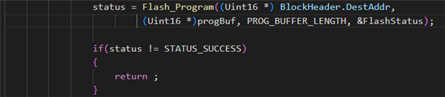

    Can you check if flash programming is successful in the flash kernel? There are a few error checks after Flash_Erase() and Flash_Program() calls, which simply return straight out of CopyData(). Instead, can you put a while(1) loop to see if there is a flash API error that you may be missing?
    Matt
  • Hi Matt,
    yes, the problem is in the CopyData() function, it enters the loop you suggested. The status is 12, so there was a Invaled Address received for the next Block.

    Are you sending the 8 reserved words between the 0x08AA key and the entry point PC?
    Also, note that even though you're configuring for an 8-bit data stream with 0x08AA key, the size of the block is defined as the number of 16-bit words in the block for both 8-bit and 16-bit data stream formats. For example, to transfer a block of 20 8-bit data values from an 8-bit data stream, the block size would be 0x000A to indicate 10 16-bit words.
