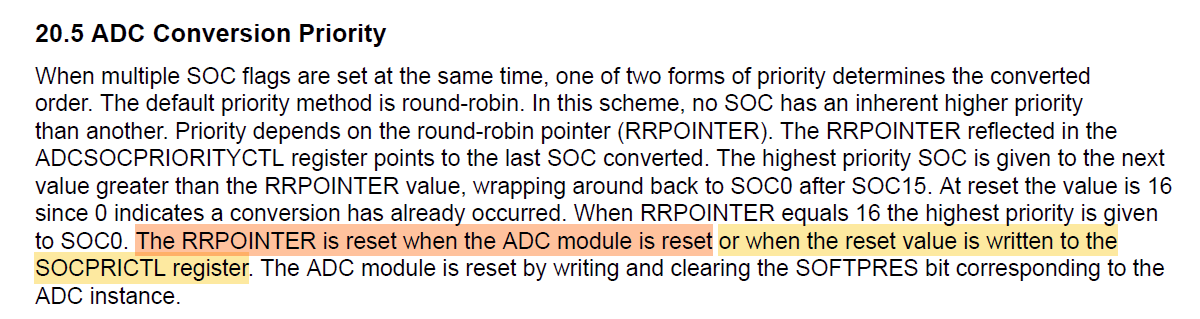

I read the following from section 20.5 ADC Conversion Priorty, pg. 2581 from the "TMS320F2838x Real-Time Microcontrollers With Connectivity Manager" Technical Referance Manual (TRM) Literature Number: SPRUII0F
My goal is to convert two SOC's in burst mode and then reset the RRPOINTER. I do not need any high priority SOC's. I'm also not sure if it is necersarry to reset the RRPOINTER either.

// Reset Priority register to clear the RRPOINTER?
AdcaRegs.ADCSOCPRICTL.all = 0x00;
EDIS;
    For this use case, you typically do not need to reset the RRPOINTER after each burst. The RRPOINTER is only used by the round-robin arbitration logic when multiple SOCs are pending at the same time. If you are only using SOC0 and SOC1 on ADCA, and these are the only SOCs participating in the burst, then the conversion sequence is usually straightforward and there is no need to manually reset the pointer after every software trigger.
    To be clear, this mechanism is intended more for reinitialization of the ADC priority logic, not as a normal step after each burst. So in your example, routinely writing ADCSOCPRICTL.all = 0 after every conversion burst is not recommended unless you specifically want to reinitialize the priority configuration.
