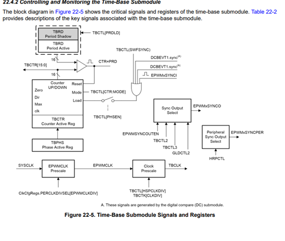

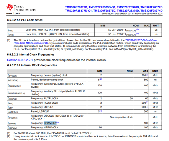

I haven´t found a clear definition, what the maximum clock frequency of the epwm module in the F28P65 device is. I come from the F28379 DSP, in this device the frequency is limited to 100MHz.
I have found in chapter 3.7.3.3 of the TRM the following text.
Are you sure that 200MHz is allowed with the F28P65 device?
Best regards
Ralf
I would suggest you read through the datasheet it is very clear from there and specified explicitly for each device
F28379D -->
f28p65x -->
Dear Prarthan,
you are right, I have searched for this table in the documentation of the device, but I hadn't found it in the data sheet. Now it´s clear!
Thanks for your support.
