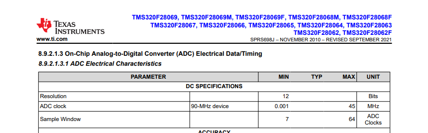

Iam using TMS320F28069 controller for my application. when iam using ADC perpheral, I found in TRM that ADC Clock is configured based on the "ADCCTL2" register configuration. If i set "CLKDIV4EN" & "CLKDIV2EN" bits of ADCCTL2 to 0, the truth table is showing the ADC clock = SYSCLK = 90MHz. But, Max. ADC Clock in data sheet of the controller is given as 45MHz.
So, My question is what will be the ADC Clock if I run my controller SYSCLk = 80 MHz and the ADCCTL2 register is not configured, it has its default value?

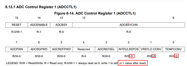

Also please let me know where can I find the default Values of the registers in the TRM?
The above snap is from TRM.
the Below snap is from datasheet
