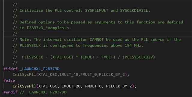

    What address does APP_START_ADDRESS point to? Is the bootloader executing at 200MHz? Can you also provide your application's linker command file for additional context?
    We have also seen issues when customers use a function pointer implementation for branching. Can you try using inline assembly with the LB instruction directly to the app's codestart?

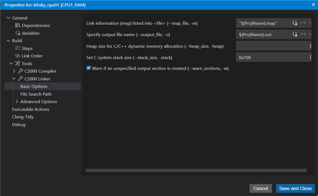

    Thank you for trying that, the linker command file / jumping mechanism generally looks okay to me. I will note if there any timers/peripherals used by the bootloader (like SCI or CAN), it is best practice to reset or de-initialize them before jumping to avoid unexpected state behavior in the application. Can you also confirm there is enough space allocated for the stack?
    Matt
  • Hello Matt,
    I have already done the below iterations :-
    1. Reset/deinit all the peripherals used.
    2. Function pointers, assembly code, software reset, watchdog reset to go to the new app but It didn't work.
    3. I have given almost all the memory available to the App project which can be seen in the linker I sent you.
    4. I have also tried hardware power reset instead of software or function pointers to execute the app. but it crashes.

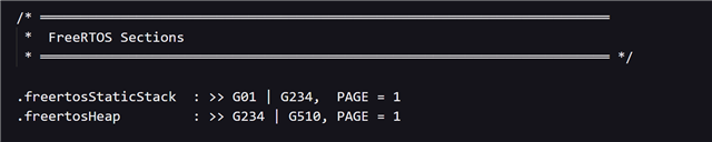

  • Hi Smeet,
    For the linker allocation in the RTOS application
    The stack sections must be in the lower 64Kb since the stack pointer is limited to this range. If there are any dynamic tasks, the heap will also have the same restriction. You can define configAPPLICATION_ALLOCATED_HEAP and manually place the heap object in this range.
    Apart from this, I don't see any reason why the RTOS app should behave differently from the baremetal app after loading, provided it runs fine standalone. Let me know if you see any changes.

    That is unusual. Can we check the following:
    1. Do you have the symbol "_LAUNCHXL_F28379D" defined for your project? This is important for the clock settings used by InitSysCtrl()
    2. When you call DELAY_US(), the argument '500000' may overflow depending on how the macro evaluates it. Use the 'UL' suffix to force unsigned long arithmetic
    3. Please also try increasing the stack size in the project properties:
    Matt
