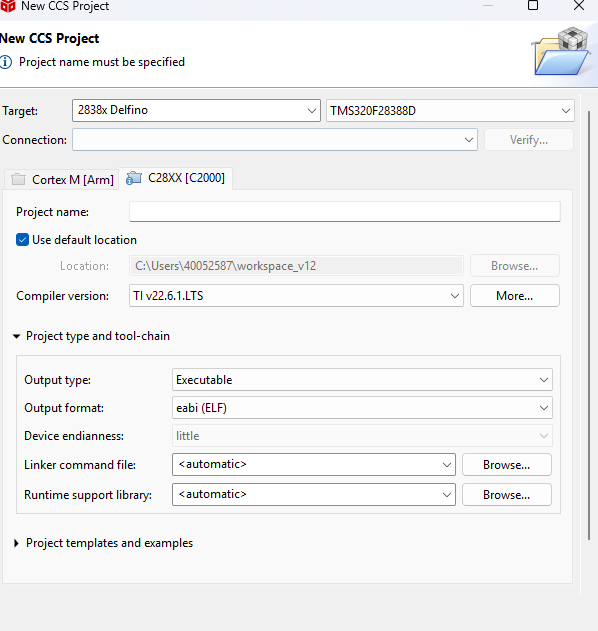

  • When creating a new project in CCS, TI‑provided example projects appear generic, and it’s unclear how to ensure the project is truly CPU1/CPU2‑specific.
  • Because of this, I’m unsure whether my CPU1 project is correctly set up to handle flash configuration and CPU2 booting. (Becuase it throws error when I write boot commands)
How to correctly create or identify a CPU1‑dedicated CCS project suitable for:
  • Flash configuration
  • Flash sector allocation
  • CPU2 boot control
What is the recommended way to manage this kind of cross‑CPU flash logging use case on F28388D without running into flash ownership or boot configuration errors.
Below is the image for creating new project - no option to select the CPUs

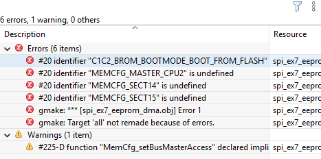

When I use an example project (dual empty projects with sysconfig - as recommended by Ti), I enable the flash in sysconfig and write the below line of code in c. But when I build it, errors are present
void main(void)
    Device_init();
    Device_initGPIO();
    Board_init();
    MemCfg_setBusMasterAccess(MEMCFG_SECT14, MEMCFG_MASTER_CPU2);
    MemCfg_setBusMasterAccess(MEMCFG_SECT15, MEMCFG_MASTER_CPU2);
    Device_bootCPU2(C1C2_BROM_BOOTMODE_BOOT_FROM_FLASH);
    while(1)
This has blocked me from working further on the project. Let me know how to solve it.

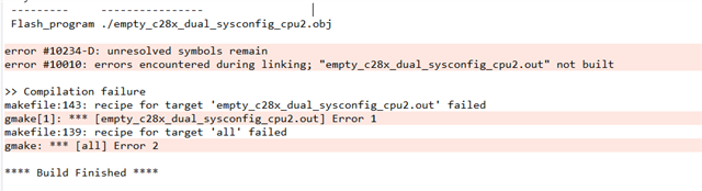

    The CPU1 project builds successfully without any errors.

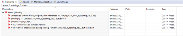

    Problem
    When I try to build the CPU2 project, I encounter multiple build errors. I’m unsure why these errors are appearing or what I might be doing wrong.
    Below is the error
    Below is my main.c from CPU2

    void FaultLog_store(FaultRecord_t *fault)
    Flash_claimPumpSemaphore(FLASH_CPU2_WRAPPER);
    // Example: append or overwrite logic here
    Flash_program((uint32_t *)FAULT_LOG_FLASH_ADDR,
    (uint32_t *)fault,
    sizeof(FaultRecord_t) / 2);
    __interrupt void IPC_0_ISR(void)
    // Acknowledge IPC flag
    IPC_ackFlagRtoL(IPC_CPU2_L_CPU1_R, IPC_FLAG0);
    // Copy MSGRAM fault record (important!)
    FaultRecord_t fault = cpu1FaultMsg;
    // Store in flash (CPU2-owned)
    FaultLog_store(&fault);

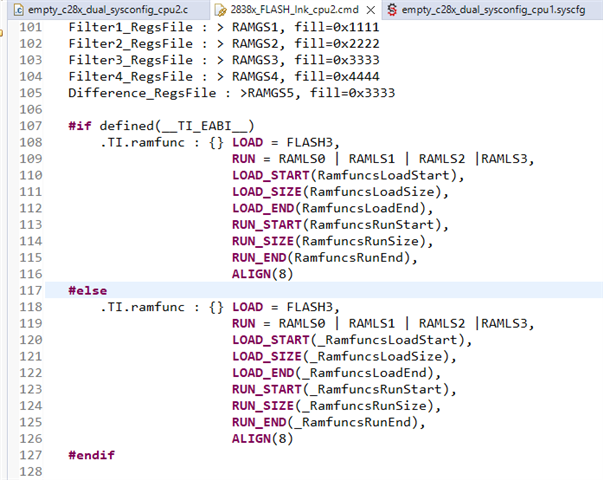

    Below is the linker modifications

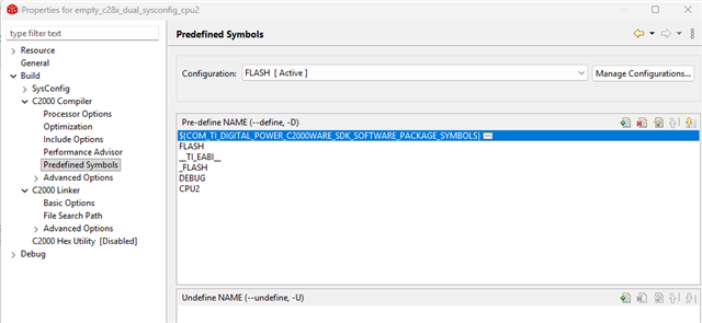

    Below is the symbol configuration
    Below is the general configuration
    Reshma
  • Hi Reshma,
    For your CPU2 project, can you remove the FLASH symbol and keep only the _FLASH symbol?
    Ira
  • Yes, Ira. I removed it and it still has the same errors.

    A few details would help refine the answer further:
    • Are you using COFF or EABI executable format?
    • Which C2000Ware version is installed?
    • Does your linker command file already have a .TI.ramfunc section configured?
    Ira
  • Hi Ira,
    I am using empty_c28x_dual_sysconfig example project. In that I'm under CPU2 project. Most of the settings are same apart from the ones that I have already shown before in screenshots.
    1. It is EABI executable format.
    2. I have installed C2000Ware_26_00_00_00. Most of my settings come from this file that has been shown in the screen shots from before.
    3. .TI.RAMFUNC is preset.

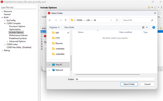

  • Hi Reshma,
    Can you check if you have "C2000Ware_26_00_00_00\libraries\flash_api\f2837xd\lib\F021_API_F2837xD_EABI.lib" library added to your project? If not can you please add it?
    Ira

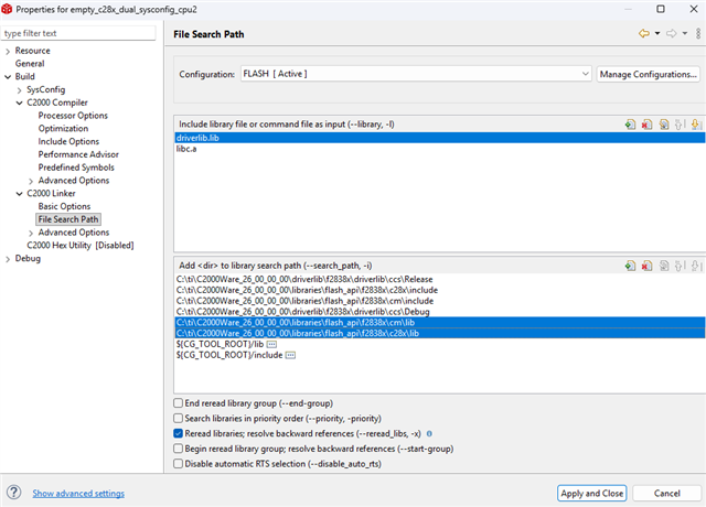

  • Hi Ira,
    I'm using F28388D MCU. There was no option to select this MCU during new ticket creation in the community portal. Hence, I have selected a MCU close to this.
    Similar to what you have mentioned, I have already added those files into my project. You can see it in my previous images. I am attaching it again for your reference. Here, I'm only able to add till lib file. Further selection is not possible since during selection it shows empty. I've attached the screenshot for that also.
    Reshma.
  • Hi Reshma,
    In your first screenshot, in the Include Library File field , select the add option (the green + symbol), and try to add F2838x_C28x_FlashAPI.lib from the "C2000Ware_26_00_00_00\libraries\flash_api\f2838x\c28x\lib\" path.
    Are you able to do that?
    Ira
  • Hi Ira,
    No, I'm not able to add "F2838x_C28x_FlashAPI.lib" from "C2000Ware_26_00_00_00\libraries\flash_api\f2838x\c28x\lib\" path. My second screenshot shows the same.
    Right now, I have put these libraries under settings/c2000 linker/file search path. Is that the right place to be put in?
    Should I put them in include options> (settings/build//c2000 compiler/include options)? Here also, I tried adding "F2838x_C28x_FlashAPI.lib" from "C2000Ware_26_00_00_00\libraries\flash_api\f2838x\c28x\lib\" path. But here also, I don't see that option.
    Reshma.
  • Hi Reshma,
    I've sent you an email requesting for a debug call.
    Ira
  • Thanks Ira,
    The call really helped me understand what was going on.
    The "Flash_program" function was not being called properly because of which the errors were popping up. Once it was commented out for testing. The build was fine.
    Thanks again.
