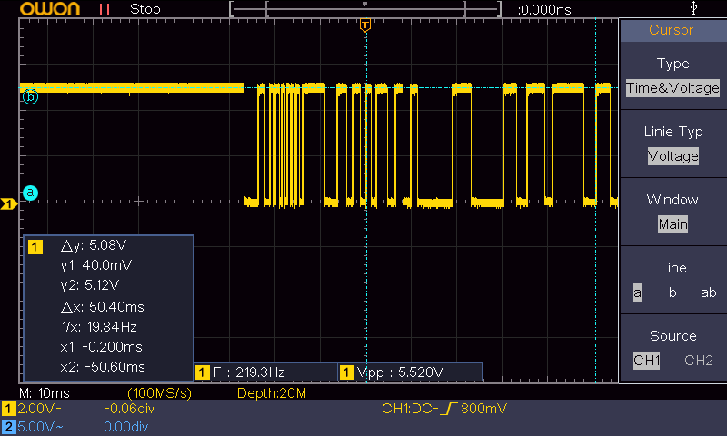

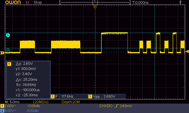

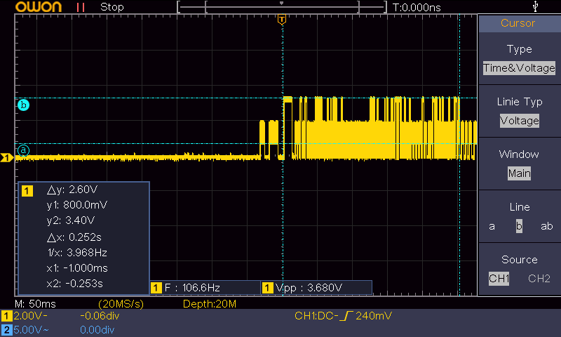

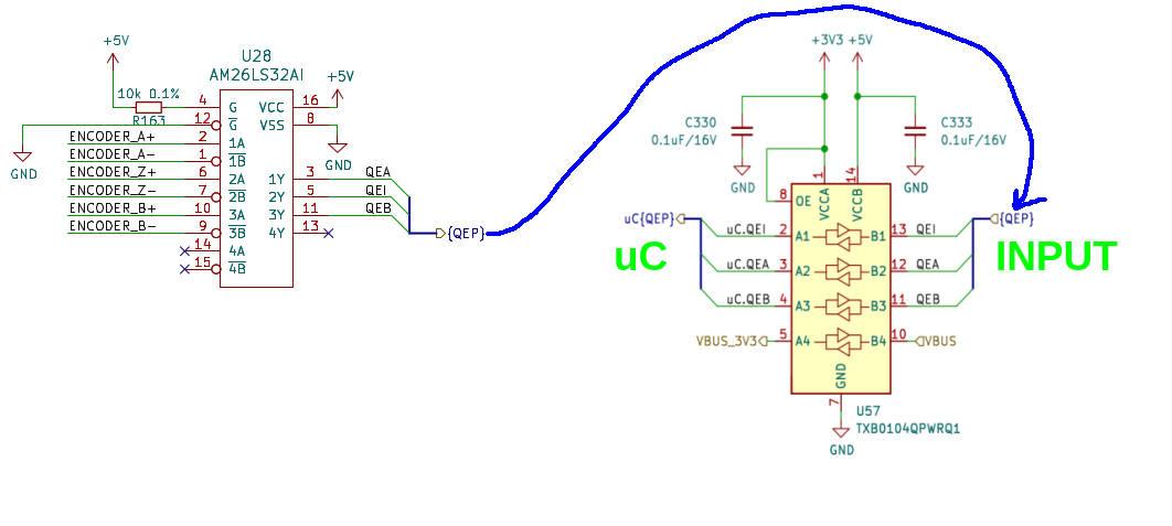

I am currently migrating a motor controller board to a 3.3V system using the F28P659DK microcontroller. To interface my original 5V encoder circuit with the MCU, I implemented a voltage translator; however, I’ve found that the chip outputs are unstable.
I would like to share my current schematic and oscilloscope waveforms to see if this behavior is expected and if there are any recommended workarounds.
Encoder circuit
Voltage translator input waveform
Voltage translator output waveform

  • Hi Luciano,
    Please help to check if there are any long cabling/ heavy capacitive loads at  the outputs of the device. The oscillations are generally caused by unintentional triggering of the internal one-shots, due false triggering. Here is an app note that covers additional details: www.ti.com/.../scea135.pdf
