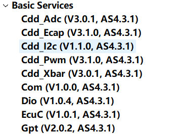

  3. As shown in the figure below, Adc/I2C/PWM module is standard AUTOSAR module, Why are these modules set as complex driving modules? According to the user guide, the functions of these modules comply with the AUTOSAR 4.3.1 standard, but the module interfaces and type definitions do not comply with the AUTOSAR standard;

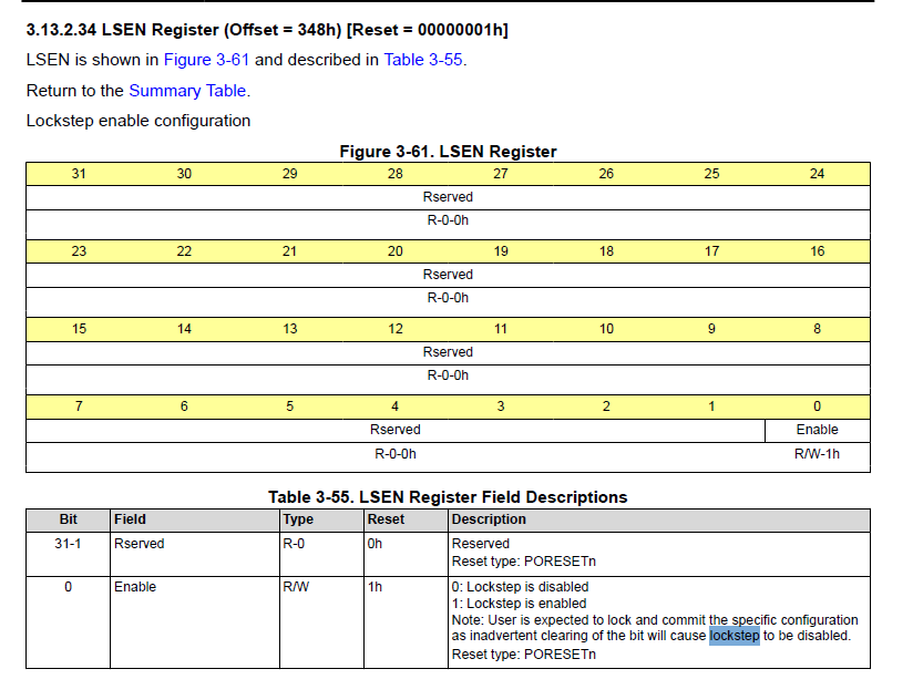

    Is the lockstep of the CPU also manually set through CDD code?
    -> In v01.04.01, the device operates in lockstep mode by default. From the next release, user will have the option to select this via RA configurator in EB Tresos. As of now, the user will have to manually disable lockstep mode if not required.
    -> The decision for the modules to be CDD is based on a few parameters:
    • The MCAL module doesn't exist in 4.3.1 AUTOSAR [I2C, DMA]
    • The in board IP offers more features than what AUTOSAR prescribes [ADC]
    • The IP doesn't adhere to basic AUTOSAR naming or functional constraints [PWM]
      Because of these, the modules don't qualify as MCAL, hence CDD
    zhentao Reply: Is the default lockstep implemented in CCS project? It's not related to the EB setting, right?
    zhentao Reply: Let's analyze it when we need to use it;
    -> Lockstep is supposed to be enabled and disabled in the start up code. The user must update the below register in the startup code to configure lockstep:
