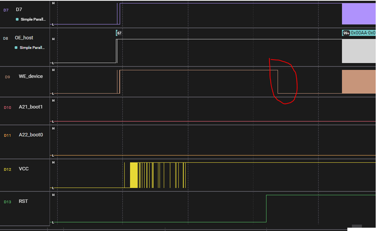

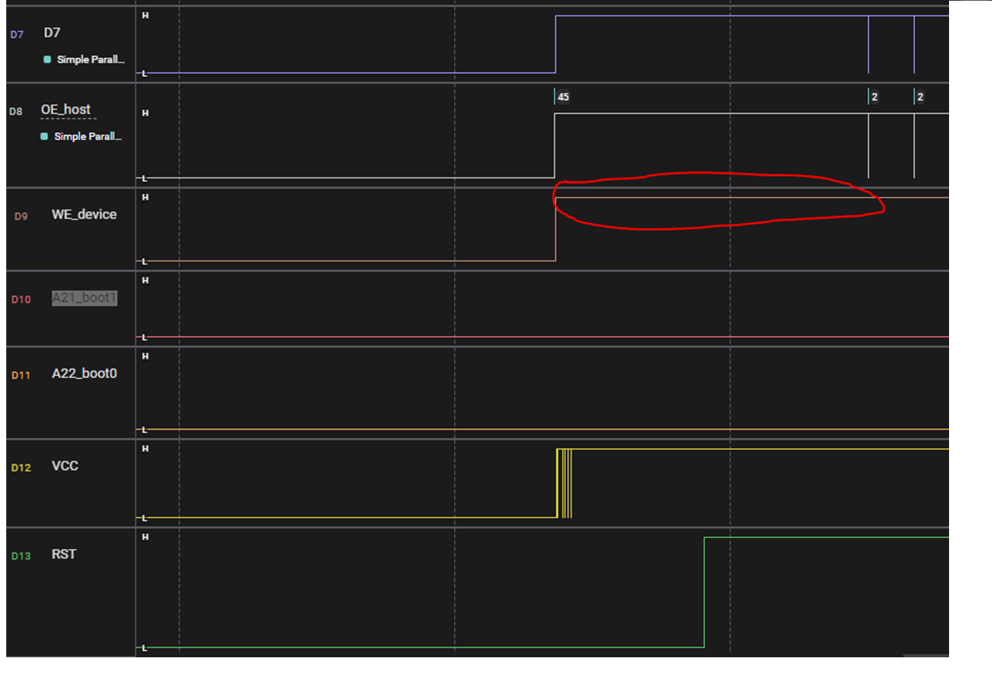

We need to use Parallel boot mode to downloader our own bootloader to the RAM,
But we found this mode seems did not work as other similar devices e.g TMS320F2800xx.
the pins for parallel mode seems different in datasheet and TRM. we use the pins described in datasheet.
we use the GPIO0-GPIO7 as parallel interface, GPIO10 as C28_Control and GPIO11 as Host_Control,
boot0(GPIO84) and boot1(GPIO72) keep low when power up. we set the Host_Control GPIO11 high,
but the C28_Control always keep high. see the wave log for the 2 device. I captured the wave of TMS320F280049 and this TMS320F28P650SH when start parallel mode, see the 2 pictures
so is there any special for TMS320F28P65SH that to use the parallel mode.
