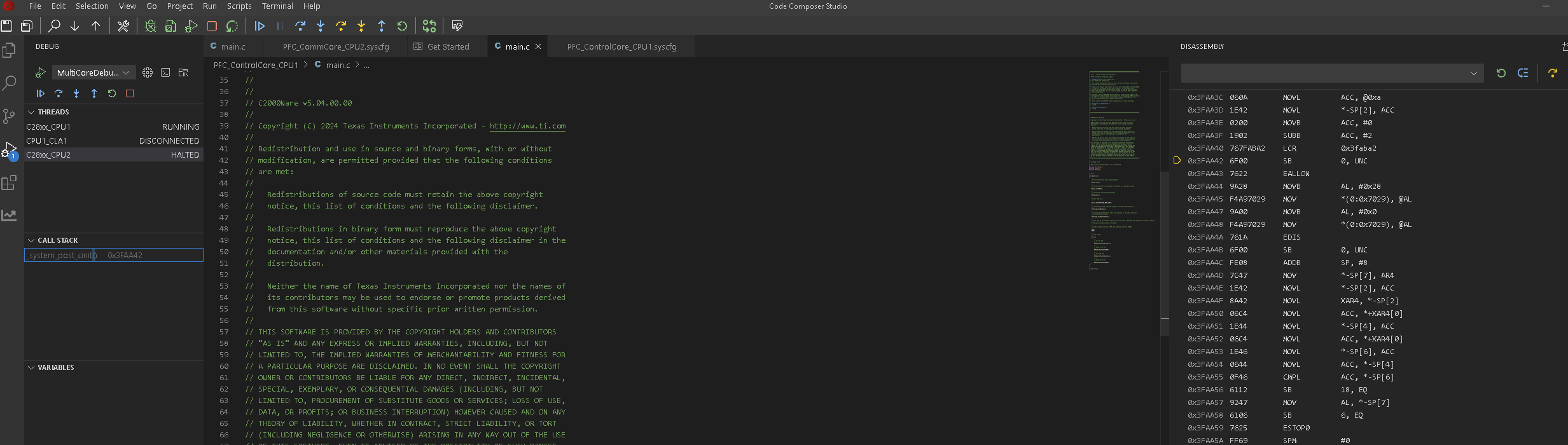

I am using TMS320F28P650DK9  ControlCard as the development platform with CCS 20.4 as the IDE.
Also, my reference is https://software-dl.ti.com/C2000/docs/C2000_Multicore_Development_User_Guide/debug.html#loading-program-in-multiple-cores
My steps for a debug session is -
  1. Launch a dual-core project-less debugging session,
  2. Connect to CPU1 and halt it
  3. Connect to CPU2 and halt
  4. Load Program (.out file) in CPU1 and run the program (to allow CPU2 booting)
  5. Load program on CPU2.
When I pause or put a breakpoint on CPU2 side, it is always stuck at 0x3FAA42 location with infinite loop and never makes to main.
Here is how the session looks like when the issue occurs
My Target config file for Debug is

Pl. help by providing a reliable way to debug on CPU2
    Jus a few questions,
    1. Are you attempting RAM or Flash based debugging?
    2. Is this project an example from our SDK? Can you attempt a multi-core example from our SDK
    3. Are you using RAM or Flash to debug this project?
  • 1. RAM
    2. Yes, it is based on C28_dual empty project example found withing C2000Ware for p65 family of DSPs.
    3. RAM
  • Hi Jwalant,
    Can you attempt a different example such as ipc_ex3_basic_sysconfig?
    When attempting this example do the following steps:
    2. Connect to CPU1 and then CPU2
    3. Load CPU1.out to CPU1 and let it run
    4. While CPU1 is running load CPU2.out to CPU2
    CPU2's file should start at main and allow you to step though the code. Additionally you should be able to set breakpoints as you please.
    Also please check that when you start a project-less debugging session, you toggle active breakpoints under the breakpoints section
  • This approach seems to be working. Can you recommend how to automate some of that through GEL file or some other method? Thank you.
