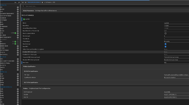

  • This is my project Sysconfig view for CPU1, as you can see that it does not have any selection for SCI's assignment to a core, this is  CCS 20.04
    What am I missing?

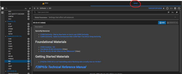

  • Hi Jwalant,
    Within syscfg please go to the SYSCTL module as seen below. Here you can assign the peripheral to CPU1 or CPU2 as desired. As I mentioned before please make sure you are calling Board_init(); within your main code as this is the function call that will transfer the ownership after you have selected this in syscfg.
    To double check that this ownership transfer has occurred, you can view the CPUSEL registers within DEVCFGREGs and step through the code. Once Board_init(); has been called you should see the transfer occur.

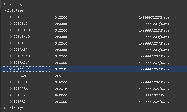

    Thanks for the reply! I ensured that on CPU1 side when I have Board_init() is called, the CPUSEL5 register at CPU1 does set the SCI_A bit. Hence, the ownership must be getting transferred. However, it still does not work. Here are my two questions:
    1. I need to enable RX interrupt and register a handler using Syscfg, currently, For CPU1 and CPU2 project, I am adding SCI A entry in syscfg - CPU1 sections in both  projects. But how do I register RX interrupt handler to be on CPU2 side?
    2. Apart from the handler, when I step through the code which loads a byte inside SCI TX Buf register, I noticed that from CPU1 registers that the SCI A port seems to be configured correctly. However, looking at CPU2 registers, SCI A does not seem to be configured at all! So, when CPU2 side routine, tries to load a byte, it does not work! What am I missing? Below is the snapshot of CPU 2 register view.

  • Hi Jwalant,
    Thank you for your explanation, I understand your goal now.
    Step 1 is correct, you do need to transfer ownership of the SCI module via CPU1 to CPU2.
    However once that ownership has been transferred, all configurations for that SCI module need to come from CPU2 as it now has ownership of the module. Any changes made to that SCI module in the CPU1 syscfg file won't be reflected as the CPU does not have ownership anymore.
    Once you have made the correct configurations within the CPU2 syscfg file, please make sure that you again have Boardinit(); called on the CPU2 side as this will be what initializes the changes you made within CPU2's syscfg.

    Thanks for the reply, meantime after some fiddling, I have the SCIA working. However, now I see another issue related to RX interrupt.
    Specifically, when the CPU2 program runs, it prints a string through SCIA. That works perfectly. However, RX interrupt is not triggered when a character is sent to SCIA.
    I compared my single core version of the project against the dual core version (where I am having the issue).  What I noticed is that it looks like that CPU Interrupt registers are not set right. Both IER and IFR show 0x0000 at runtime. On the single core version it was enabling the interrupts correctly. I believe this is the reason of RX interrupt not working.
    When I compared syscfg files for single vs. dual core, they match perfectly for SCIA config. The other observation is that board.c generated by syscfg utility also match closely (except in dual core, the pinmux for SCI is listed under CPU1, but SCI config is listed  CPU1.
    So, I wonder if that is causing the issue. Thanks again.
