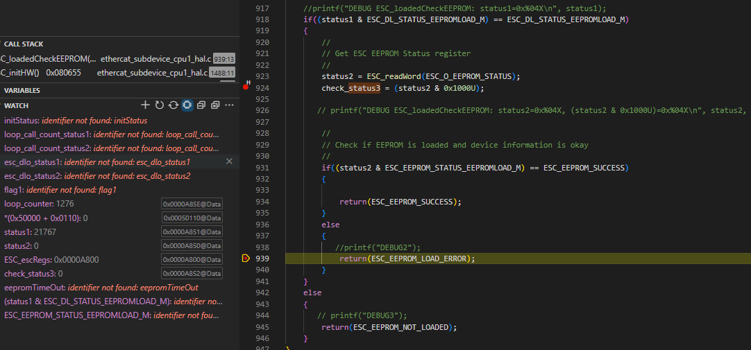

    But i had one more question:
    I had declared
     volatile uint16_t status2;
    #define ESC_EEPROM_STATUS_EEPROMLOAD_M 0x1000U
    #define ESC_EEPROM_SUCCESS    0x0U
    When I am adding no op instruction in else part its going into line "return (esc_eeprom_success , screenshot 2 "after condition check , otherwise without no op its going into its going to line ("esc_eeprom_load_error" , screenshot 1) . Can you help me clarify. If everything is correct with or without no op it should go to line with ("return esc_eeprom_sucess") statement. (check_status3 is added to watch expression for debugging.)
    Similar to e2e , TMS320F28034: f28034, the program takes the wrong branch/path - C2000Tm︎ microcontrollers - INTERNAL forum - C2000Tm︎ microcontrollers - INTERNAL - TI E2E support forums
    Can you please help me understand this behaviour?
    I have created a simple program with only those statements for reference and attached, same behaviour is observed :
    device : f28p65x launchpad
    optimization : 2
    5504.led_ex1_blinky.zip
  • Also please suggest way of solving the issue without nop or delay.

    This example does not seem to apply to the example for the reading the values when halted vs real-time mode. Can yo provide your example for that one.
    As for your other question, please create a new thread for this question since it is a different issue and may need to be investigated my someone else.
