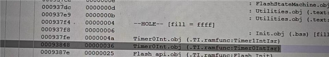

  • Hi Fleenor,
    1. In EABI project, for this function, if customer use pragma to allocate the Timer0IntIsr to .TI.ramfuc, it can successfully
    but for this gwFileInfo, if customer use pragma, it can't be placed in app_file_info section(can be placed in app_file_info section in COFF project using pragma)
    customer need to use attribute to realize their requirement
    Is it must to change all the pragma to attribute when customer migrate COFF to EABI?

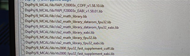

    2. Customer use below lib
    Could you give the latest version of these lib and give me the release note for these lib? can't find specific information in C2000ware SDK release note
    3. Is needed to replace the driver source when it migrate from COFF to EABI?

  • Hi Shuqing,
    Addressing your three follow-up questions directly.
    1. Must All #pragma Be Changed to __attribute__ When Migrating to EABI?
    No — not all pragmas must be converted, but the behavior differs between functions and unreferenced data.
    The reason #pragma CODE_SECTION(Timer0IntIsr, ".TI.ramfunc") works is that Timer0IntIsr is an ISR – it's referenced by the interrupt vector table, so the ELF linker doesn't strip it. The pragma successfully places it in .TI.ramfunc because the linker sees it as "used." (See image of code and map file verifying this.)
    However, gwFileInfo (a constant variable placed in a custom section like app_file_info) is not explicitly referenced by other code – it exists for external tools, debuggers, or fixed-address reads. In ELF, the linker’s unused-section elimination strips it silently. That’s why #pragma DATA_SECTION alone fails for this variable, but it works in COFF (where everything was kept regardless). (The images show the conversion from #pragma DATA_SECTION to __attribute__((retain, section("app_file_info"))) for gwFileInfo.)
    The rule is:
    • If a symbol placed via #pragma DATA_SECTION or #pragma CODE_SECTION is referenced elsewhere in the code, the pragma syntax still functions in EABI.
    • If the symbol is unreferenced (calibration data, version info, fixed-address constants), you must add __attribute__((retain, section("..."))) or #pragma RETAIN to prevent stripping.
    Practical recommendation: Audit every #pragma DATA_SECTION in the project and add __attribute__((retain, section("..."))) for any variable that isn't directly referenced in code. For referenced symbols, the pragma syntax still functions, but converting to __attribute__ syntax is the forward-looking best practice for EABI. This adds clarity and can improve future maintainability.
    2. Library Versions and Release Notes
    Based on the image provided, you're using libraries from C2000Ware 6.00.01.00. The file names in the image confirm the availability of both COFF and EABI versions.
    Here's a summary of relevant information:
    • F28003x support (driverlib, bitfield, SysConfig, and libraries) was first added in C2000Ware 4.00.00.00.
    • EABI Flash API libraries for F28003x were added starting in C2000Ware 4.00.00.00, with a Functional Safety Quality Flash API v1.58.10 for F28003x added in 4.02.00.00.
    • IQmath, driverlib, and device libraries are updated with each C2000Ware release
    • Both EABI and COFF library versions are distributed in C2000Ware, and compilation requires "Enable support for GCC extensions" (enabled by default in compiler v6.4.0+).
    • Important: Make sure you are linking the EABI versions of the libraries (e.g., driverlib_eabi.lib, cla2_math_library_eabi.lib, its2800_fpu32_fast_supplement_eabi.lib) to your project, as shown in the provided image.
    The detailed per-library changelogs are embedded within the C2000Ware installation directory rather than the top-level SDK release notes. Look in:
    C2000Ware_x_xx_xx_xx/libraries/flash_api/f28003x/
    C2000Ware_x_xx_xx_xx/libraries/math/IQmath/
    C2000Ware_x_xx_xx_xx/driverlib/f28003x/

  • Hi Fleenor,
    1. I want to emphasize again customer isn't use C2000Ware 6.00.01.00, please check for the picture again!!!
    2. I can't find these library release note in below path, please check again!!!!
    3. I just want to know the latest library now we released and these library release note, please answer me directly!!!
    How I can trust you other question's answer??
    BRs
    Shuqing
  • Hi Shuqing,
    1) The pictures you shared show use of C2000Ware 6.00.01.00.
    Can you help me understand what version is being used then?
    2) Apologies for the previously incorrect reference to changelog details. The associated details can found in the locations below:
    C2000Ware_26_00_00_00\libraries\flash_api\f28003x\docs (Flash API Library specific - See Page 40 of the PDF)
    C2000Ware_26_00_00_00\change_log.html (Detailed changelog with changes/updates across C2000ware)
    3) The latest C2000Ware release will always contain the latest version of the associated libraries, this is always available for download at:
    https://www.ti.com/tool/C2000WARE/#downloads
    The latest release can be found at:
    https://www.ti.com/tool/download/C2000WARE/26.00.00.00.STS
    I hope this properly addresses your questions.
