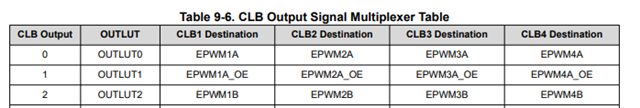

    This is done by selecting the the correct output in the Overriding Outputs selection. To do this for EPWMxA the example uses Output0 which is OUTLUT0. But for EPWMxB you need to use Output 2 which is OUTLUT2, as seen in the table below. Can you confirm that you are using the correct Output to be overwritten?

    I know how to use OUTLUT2 to export epwmB. However, cause I xor 3 epwms, the outputs of epwmB and A do not meet deadband requirements.
    So, I just ask for a way to handle this issue or recommend an alternative approach to maintain correct deadband behavior?
