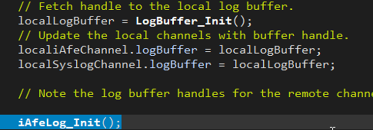

The C-code snippet.

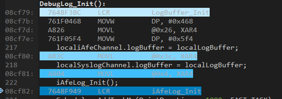

The related assembly, as shown in the debugger
And the same assembly highlighted, bacause the collers in CCS dark-mode is a bit broken ;-)

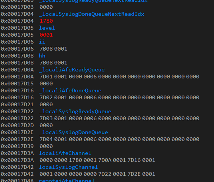

And a snippet of the memory layout

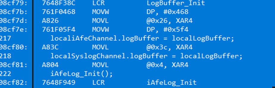

The assembly for write to the first struct is:
`08cf80:   A83C        MOVL         @0x3c, XAR4`
with the DP = 0x5f4, the `@0x3c` points to address 0x17d3c, which matched the structs mambers location in memory.
But the assembly for write to the second struct is:
`08cf81:   A804        MOVL         @0x4, XAR4`
with the still being DP = 0x5f4, the `@0x4` points to address 0x17d04, which don't match the structs member, but instead writes to the area where the variables `_localSyslogDoneQueueNextReadIdx` and `level`. As you can also see the debugger highlighted in the momory view.
As far as I can see the correct assembly should have been:
`08cf81:   A844        MOVL         @0x44, XAR4`

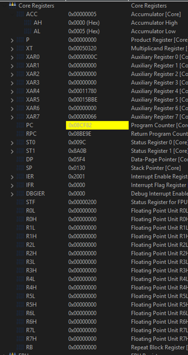

And for completenes here is the state of the registers,

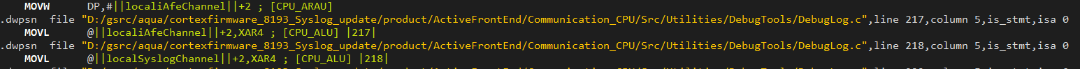

  • Update
    It appears to happen at link-time
    If I add the `--keep_asm` to the compilation of the file
    I find this in the asm file
    ;* FNAME: DebugLog_Init                 FR SIZE:   0           *
    ;* FUNCTION ENVIRONMENT                                        *
    ;* FUNCTION PROPERTIES                                         *
    ;*                            0 Parameter,  0 Auto,  0 SOE     *
    ||DebugLog_Init||:
    ;* AR4   assigned to $O$C1
    	.dwcfi	cfa_offset, -2
    	.dwcfi	save_reg_to_mem, 26, 0
    	.dwpsn	file "D:/gsrc/DebugLog.c",line 215,column 5,is_stmt,isa 0
    $C$DW$226	.dwtag  DW_TAG_TI_branch
    	.dwattr $C$DW$226, DW_AT_low_pc(0x00)
    	.dwattr $C$DW$226, DW_AT_name("LogBuffer_Init")
    	.dwattr $C$DW$226, DW_AT_TI_call
            LCR       #||LogBuffer_Init||   ; [CPU_ALU] |215|
            ; call occurs [#||LogBuffer_Init||] ; [] |215|
            MOVW      DP,#||localLogBuffer|| ; [CPU_ARAU]
            MOVL      @||localLogBuffer||,XAR4 ; [CPU_ALU] |215|
            MOVW      DP,#||localiAfeChannel||+2 ; [CPU_ARAU]
    	.dwpsn	file "D:/gsrc/DebugLog.c",line 217,column 5,is_stmt,isa 0
            MOVL      @||localiAfeChannel||+2,XAR4 ; [CPU_ALU] |217|
    	.dwpsn	file "D:/gsrc/DebugLog.c",line 218,column 5,is_stmt,isa 0
            MOVL      @||localSyslogChannel||+2,XAR4 ; [CPU_ALU] |218|
    	.dwpsn	file "D:/gsrc/DebugLog.c",line 222,column 5,is_stmt,isa 0
    $C$DW$227	.dwtag  DW_TAG_TI_branch
    	.dwattr $C$DW$227, DW_AT_low_pc(0x00)
    	.dwattr $C$DW$227, DW_AT_name("iAfeLog_Init")
    	.dwattr $C$DW$227, DW_AT_TI_call
            LCR       #||iAfeLog_Init||     ; [CPU_ALU] |222|
            ; call occurs [#||iAfeLog_Init||] ; [] |222|
    	.dwpsn	file "D:/gsrc/DebugLog.c",line 224,column 5,is_stmt,isa 0
            MOV       AL,#1000              ; [CPU_ALU] |224|
            MOVB      AH,#0                 ; [CPU_ALU] |224|
            MOVL      XAR4,#||PrintDemoLines|| ; [CPU_ARAU] |224|
    $C$DW$228	.dwtag  DW_TAG_TI_branch
    	.dwattr $C$DW$228, DW_AT_low_pc(0x00)
    	.dwattr $C$DW$228, DW_AT_name("Scheduler_AddTaskMs")
    	.dwattr $C$DW$228, DW_AT_TI_call
            LCR       #||Scheduler_AddTaskMs|| ; [CPU_ALU] |224|
            ; call occurs [#||Scheduler_AddTaskMs||] ; [] |224|
    $C$DW$229	.dwtag  DW_TAG_TI_branch
    	.dwattr $C$DW$229, DW_AT_low_pc(0x00)
    	.dwattr $C$DW$229, DW_AT_TI_return
            LRETR     ; [CPU_ALU]
            ; return occurs ; []
    	.dwattr $C$DW$225, DW_AT_TI_end_file("D:/gsrc/DebugLog.c")
    	.dwattr $C$DW$225, DW_AT_TI_end_line(0xe2)
    	.dwattr $C$DW$225, DW_AT_TI_end_column(0x01)
    	.dwendentry
    	.dwendtag $C$DW$225
