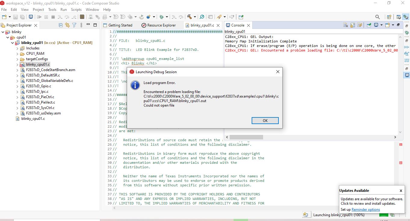

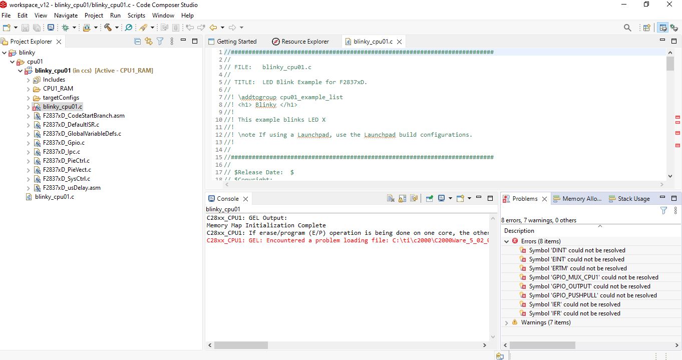

I am using the TI TMS320F28379D LaunchPad. For development, I am using Code Composer Studio 12.7.0 along with C2000Ware 5.02.00.00.
While building the example code from the provided files, I am encountering some issues. Could you please suggest a solution?
    Based on the screenshots attached looks like your program is not complied successfully.
    Check the build console for any compile/linker errors before launching debug session.
    Looks like your include paths or driverlib source filed aren't correctly linked in the project
    Check include paths — Right-click project → Properties → Build → C2000 Compiler → Include Options. You should have paths like:
    ${C2000WARE_ROOT}/device_support/f2837xd/headers/include
    ${C2000WARE_ROOT}/driverlib/f2837xd/driverlib
