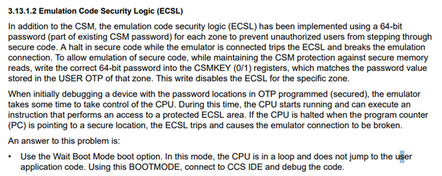

I have a secured LAUNCHXL-F280049C configure to boot from 0x80000 which I cannot attach to via JTAG. The keys have been set in the GEL file to no avail - with this error message displayed on the console:
C28xx_CPU1: Trouble Writing Memory Block at 0x5f010 on Page 1 of Length 0x2: (Error -1156 @ 0x800) Device may be operating in low-power mode. Do you want to bring it out of this mode? Choose 'Yes' to force the device to wake up and retry the operation. Choose 'No' to retry the operation without waking the device. (Emulation package 20.0.0.3178)
C28xx_CPU1: GEL: Error while executing OnTargetConnect(): Target failed to write 0x0005F010@Data
   at *((unsigned long*) 0x5F010)=<my_key_0> [f280049c.gel:80]
     at OnTargetConnect()
Is there any way to recover from this?
