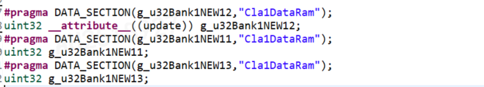

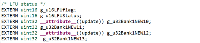

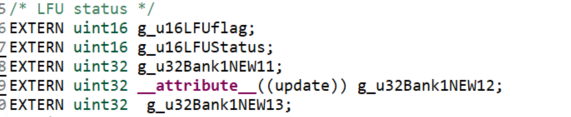

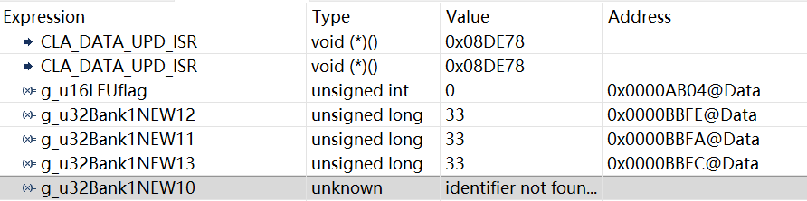

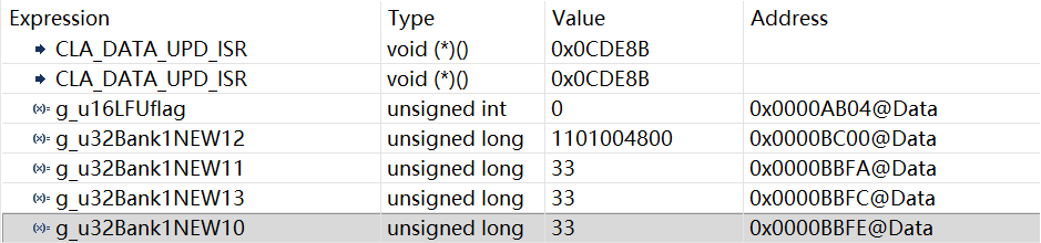

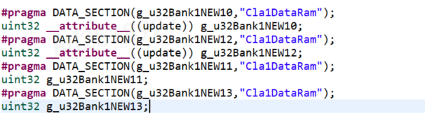

During multiple LFU processes, I encountered this problem: Firstly, the variable g_u32Bank1NEW12 was added; then, during the second upgrade, the variable g_u32Bank1NEW10 was added. After the second upgrade, the address of the variable g_u32Bank1NEW12 was sent out incorrectly. How should we design to solve this problem.
The first upgrade:
The second upgrade:

    2. All of the above applies to C28 side variables. For CLA side variables i.e. those defined and used in .cla files, there are some limitations. At present, these are not documented in the compiler user guide (spru514), but this will be addressed in a revision. The limitation is that for LFU and CLA side variables, only "preserve" is supported, "update" is not supported. In other words, for CLA side variables, the compiler can handle keeping existing variables at the same addresses during LFU without re-initializing them. However, for new CLA variables introduced during LFU i.e. "update" variables, the compiler will not perform initialization in __TI_auto_init_warm(). This has to be handled in user code.
    As such, for CLA "update" variables, the "update" attribute should not be applied.
    3. Also note that in general, DATA_SECTION use with LFU needs to be carefully handled. There are many scenarios, depending on the specific use-case the compiler may issue a warning/error. As a simple example, you cannot specify a DATA_SECTION for a variable and also specify it with an "update" attribute.
